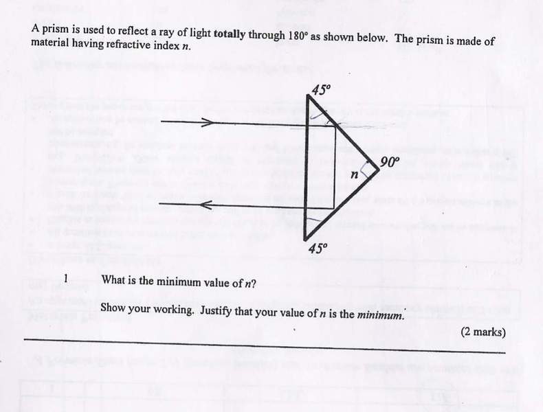

I uploaded the question below.2. The attempt at a solution
At first what I did was using the Snell's Law formula [tex]n_1 \sin{\theta _1}=n_2 \sin{\theta _2}[/tex]
then I did this, [tex]n\sin{\ 45}=1 \sin{\ 90}[/tex]
so this is the minimum value that I got n=1.41
I'm not sure if my answer is correct or not. Also how do you justify that particular n value is minimum

Total reflectance occurs here when [itex]n\sin(45)\geq 1[/itex], so [itex]n\geq 1/\sqrt{2}[/itex]. Your value is minimum as total reflectance holds for higher refractive index values, too.
