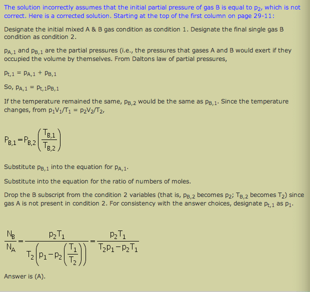

A mixture of two gases, A and B, exists at pressure p1, volume V, and temperature T1. Gas A is subsequently removed from the mixture in a constant-volume process. The remaining gas B is found to have a pressure p2, volume V, and temperature T2. Express the ratio of the number of moles of gas B to the number of moles of gas A in the terms of p1, p2, T1 and T2.
a. [itex]\frac{p_2 T_1}{p_1 T_2 - p_2 T_1}[/itex]
b. [itex]\frac{p_2 T_1^{2}}{T_2(p_1 T_2 - p_2T_1)}[/itex]
*Options c and d were not written because they contained specific gas constants which do not pertain to molar equations.
Ideal Gas: [itex]pV = N \overline{R}T[/itex]
Dalton's Law: [itex]p = \sum p_i[/itex]
Universal gas constant crosses out. Volume stays constant and also crosses out.
∴ [itex]\frac{N_B}{N_A}= \frac{p_B T_A}{T_B p_A}[/itex]
Relating pA and pB to p1
[itex]p_1= p_A + p_B[/itex]
and to p2
[itex]p_2 = p_B[/itex]
Also, [itex]T_A = T_1 \ T_B = T_2[/itex]
∴ [itex]\frac{N_B}{N_A}= \frac{p_2 T_1}{T_2(p_2 - p_1)}[/itex]
This is not an option. I have a feeling its because I assumed [itex]p_2 = p_B[/itex]. That assumption doesn't feel right. I don't know how else to relate these two. Thank you for considering this.

I got 'a', starting from
[tex]p_1V=(N_A+N_B)RT_1[/tex]
[tex]p_2V=N_BRT_2[/tex]

I got your same answer using your very clear setup. (You rock man). The solution was too good. It was elegant and made sense the whole way through...
Setting both eqs. equal to V/R:
[itex]\frac{N_A}{N_B}+ \frac{N_B}{N_B} =\frac{T_2 p_1}{p_2 T_1} \\<br /> <br /> \frac{N_B}{N_A} = \frac{1}{\frac{T_2 p_1}{p_2 T_1} -1} \\= \frac{p_2 T_1}{T_2 p_1 -p_2 T_1}[/itex]
Thats how it should be. So I went hunting for the online errata. I can't believe I didn't do this sooner!
Amazing Borek! I got to go over all the errata. Thanks a million.
