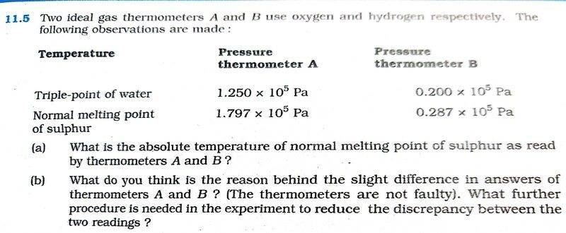

The problem is as given in screenshot below. I am unable to correctly answer part (b) of the question.
##\frac {P_1} {T_1} = \frac {P_2} {T_1}## where ##P_1## and ##P_2## denote pressures at temperatures ##T_1## and ##T_2## for a constant volume ideal gas
I am able to solve part (a) using the relationship ##\frac {P_1} {T_1} = \frac {P_2} {T_1}##, where ##T_1 = 273.16## since its the triple point of water and ##T_2 =T_s## ##(T_s = ## melting point of sulphur). I use the two readings for thermometer A to get ##P_1## and ##P_2## as mentioned in the first column under Pressure thermometer A.I use the same approach as above for thermometer B using the readings mentioned in the second column under Pressure thermometer B.
I get correct answers. For thermometer A, ##T_s = 392.69## K and for thermometer B, ##T_s = 391.98## K
For part (b), I am not very clear. The difference in readings could be due to parallax error or observation error by the person using the gas thermometer. But, I'm not sure if there is more to this part (b) answer. Also, I cannot come up with any answer to reduce the difference in ##T_s## determined by thermometers A and B since parallax error or observation error is hard to minimize in an objective manner. In other words, the discrepancy in the two readings in unavoidable and will happen randomly.

Non-ideal behaviour of gases?
Expansion of container at the higher pressure?
Expansion of both bottles at the higher temperature?

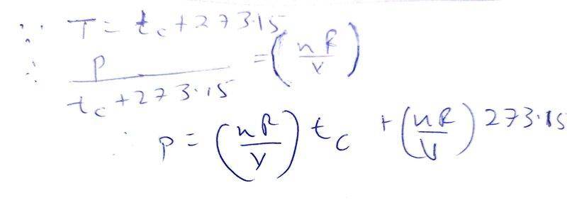

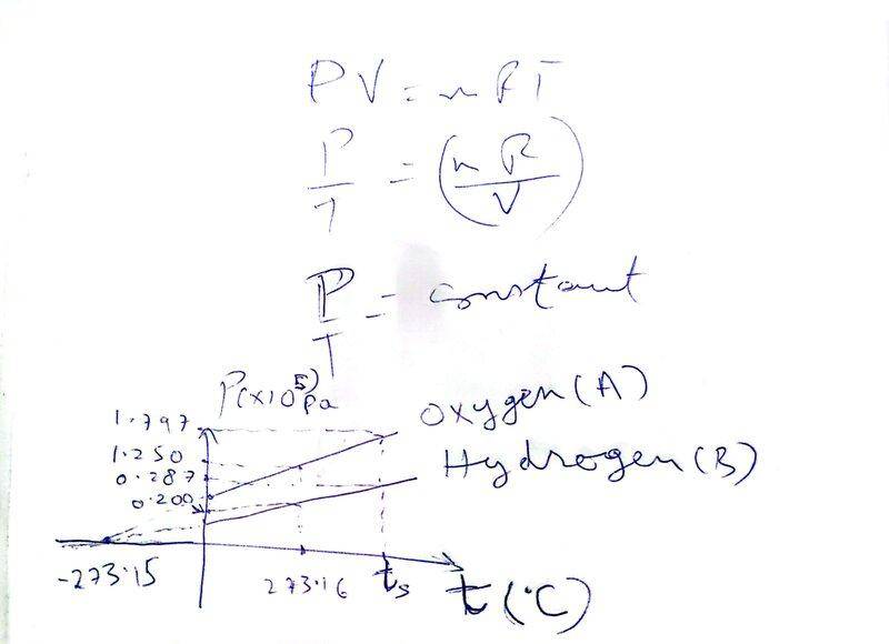

Also, I have come up with the following analysis for gases in this problem. It seems the slope of the P-tc graph is given by ##\frac {nR} {V}## in this case.
I believe the thermometer B is giving a more accurate reading for ##T_s## since the pressures recorded for thermometer B are very low compared to pressures recorded by thermometer A. Gases behave like ideal gas at low pressures and high temperatures, so applying ##\frac {P} {T}=## constant to thermometer B is more justified.

vcsharp2003 said:
I believe the thermometer B is giving a more accurate reading for ##T_s## since the pressures recorded for thermometer A are very low compared to pressures recorded by thermometer A.
That sounds reasonable You are dealing with measurement uncertainties of ~0.1% and pressures ~1atm. Deviation from ideal gas behaviour is almost certainly what the question is about.
However, the question specifically asks for some “further procedure”. Is there anything you could do (further measurements) to reduce deviations from ideal gas behaviour?
Also, note the pressure measurements are given to 4 and 3 significant figures. You can’t really justify giving the calculated temperatures to 5 significant figures; I would use 4.
I think we need to decrease the number of moles of oxygen in the thermometer A, so it gives lower pressure readings at temperatures of triple point and at melting point of sulphur. That way the oxygen gas will behave more closely to an ideal gas just like thermometer B and we'll get smaller differences in their readings. I am assuming that thermometer B with hydrogen is already at low pressures from the pressure readings mentioned in the original problem.
OR we could decrease the number of moles of oxygen as well as of hydrogen in their thermometers, so they both record low pressures.
Is the above the right approach to decrease the discrepancy between the two thermometers' readings?
Yes, that is aprobably the "further procedure" they are asking for.
OR we could decrease the number of moles of oxygen as well as hydrogen thermometers, so they both record low pressures.
Yes, reducing both pressure would be even better. Of course, if the pressure is too low, this will increase the fractional uncertainties in the pressure readings. So, best of all, you would use lower pressures for both gases with a higher precision pressure measuring device.
(Another approach would be to use a more accurate equation than the ideal gas equation. Van der Waals equation springs to mind if you have met it. You would need additional information such as the volume.)
