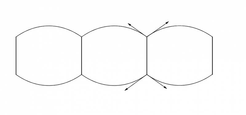

Let me complicate things a bit. Take a look at the attached picture.
Since we assume that the vertical plates are always parallel, the shape of the membrane doesn't change. It is a circle as we proved and it has the same radius at the top of the "chamber" as it does at the bottom. That's my feeling.
BUT what would the force balance for a single plate look like in this case?
Because in this case I can't figure out how to include the pressure difference into the equation, as we did in post #28. That is why in post #27 I wrote $$2\cos\varphi_0T=2p\sin\varphi_0+ph$$ thinking that the first term on the RHS describes the force (due to the pressure difference) at juncture of the membrane and rigid plate - of course as you noticed the dimension doesn't match.
  • #40
The parameter p is actually the difference between the pressure inside the chamber and the pressure outside the chamber. The pressure inside the chamber as well as the pressure outside the chamber are uniform.
Regarding the force balance equation, here is my free body diagram:
I don't see any additional contribution of the pressure to the force balance, even at the corners. The only forces acting on the end plate are the tensions of the membranes and the distributed pressure on the face.
Chet

Than I don't understand how to write a force balance equation in this case:
Since the pressure difference ##p## on the plate is zero (on the middle chamber) there is no force. And if there is no force, there is no balance.
  • #42
Have you drawn a free body diagram on either of the plates for the middle chamber? How many membranes are attached to each of these plates, (a) 2 or (b) 4?
  • #43

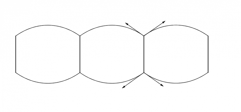

One plate, 4 membranes. (The size of the vectors on the graphics should be the same.)
  • #44
Right. So you can see that the membrane forces exerted on the two sides of the plate balance each other, and the pressure forces exerted on the two sides of the plate balance each other. So the plate is in force equilibrium.
Chet

I'm pretty confused. Here is my understanding of the problem we have solved so far (which is already an extension of the problem that we started with).
We have 3 chambers bounded by 6 membranes and 4 vertical plates. The pressure outside all three chambers is uniform. The pressures inside all three chambers are uniform and equal, and exceed the pressure outside the chambers by p. Our solution to this problem indicates that:
1. The shapes of all 6 membranes are circular arcs, identical, and symmetric with respect to the centerline of each chamber.
2. The 12 angles of the membranes at the edges adjacent to the plates are all equal to one another.
3. The 4 plates are all vertical and equally spaced.
4. The membranes and the plates are fully in static equilibrium.
Is this your understanding of what we have solved so far? Do you have discomfort with this solution? If so, for what reason?
Are you now trying to extend what we have done to a more complicated situation? Are you asking how to do this?
Chet
