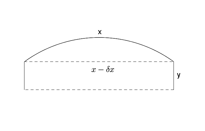

Imagine having a rectangle with horizontal sides ##x## and vertical sides ##y##. The surface of that rectangle is than ##S=xy##.
Now imagine the sides ##y## are rigid - they don't bend nor do they change their length, while the ##x## sides is some kind of cloth and is easily bendable but does not extend (it does not stretch, therefore the length is always ##x##). Now if we for some reason change the distance between the parallel ##y## sides from ##x## to ##x-\delta x## the cloth will bend outwards.
The question is:
What is the shape of the cloth if we want the surface to be maximum?
Since I probably wasn't clear enough in the problem statement, here is a rough sketch (I have drawn only the upper membrane. There should be the one symmetrical at the bottom of course).
So the arc length is ##x## and the question is what is the shape of the arc? Is it a circle, an ellipse, a sin function... Whatever.
I started this way:
The total surface is $$S=(x-\delta x)y+2S_0$$ where ##S_0## is the surface under the cloth. If i am not mistaken it can be written as $$S_0=2\int_{-\Delta}^{\Delta} f(t)dt$$ where ##\Delta =\frac{1}{2}(x-\delta x)## and ##f(t)## being the function I am looking for.
I tried to solve the problem using Lagrangian multiplier and setting a constraint of constant perimeter ##2x+2y=const.##
But I didn't come very far... Is there another way? :/

We can reduce it to maximising the area under a curve of given length L from origin to a point B on the x axis.
If you have been taught calculus of variations that is probably the method you are expected to use. But you need to use the generic expression for length of an arc over dx, ##\sqrt{1+p^2}.dx##, where p=dy/dx. You will also need a Lagrange multiplier, of course, and the Euler-Lagrange equation.
However, if we can assume a circle maximises the area of a closed loop of fixed length, there may be an easier way.
Suppose an arc of a circle of the given length would have radius R, and mark the centre of curvature, C.
So OC=BC=R. Suppose the angle OCB happens to be a rational multiple of pi. Can you see how to relate the problem to the area of a circle?

The way I read the OP, it asks what shape of the bendy bit maximises the area for a given displacement of the sides. You now seem to be suggesting that the area is also to be maximised wrt the displacement, which is a different question.
If we accept (or prove) the best is the arc of a circle for a given displacement, then it should be relatively straightforward to find the displacement that maximises it.

You will get the same result for the same reason. If you consider a fixed δx, the shape of the membrane will be a section of arc (in the same way it has to be this shape if the rest of the figure would be the rest of the circle). You can calculate its area, add twice its value to y(x-δx) and maximize that sum.
This solution also happens to minimize energy in the physics case.
