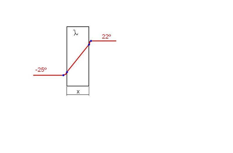

Hello all,
Maybe this is a simple question. I've done some calculations like this, but for heating in buildings. Now it's different.
I have some crystals I must keep cold, at -25ºC. So I will surround them with an insulation material wall. Outside we have atmosphere temperature
I want to see which material is better (Rohacell, Styrodur...), I know the thermal conductivity, I know the temperatures, but I don't know the thickness of the wall to reach the -25º.
I send a picture to illustrate the problem. I know that on the faces of the wall there is convection and radiation, I think here is the biggest problem.
So, my question is how to calculate the thinkness of the wall (it's just one material)
Thank you!

The thickness doesn't set the temperature.
If there is a temperature difference between the inside and the outside, heat will inevitably flow into the crystals and (unless there is some refrigeration source) they will reach the outside temp. All the insulation can do is slow this process.
You can work out the power flow and so the time to melt from the insulation factor and the thickness.

The insulation can only affect the power reaching the sample.
If you have a cooling mechanism then the part is going to stay at -25c as long as the heat flow is small enough that the cooling mechanism can cope with it.
The insulation material will have a thermal conductivity in W/mK so:
heat flow = conductivity * temperature difference * area/thickness
The area you know (the surface area of your container) the temperature difference is fixed so for a given cooling power you can set the thickness.
Alternatively you can use the same equation to work out what the sample will heat up to until the heat flow balances the cooling power. A lower temperature difference means less heat flow.

i can live with the heat flow
but the problem is how to calculate de global K of the wall. i have the K of the material but there is still missing what happens in the faces of the wall
