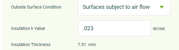

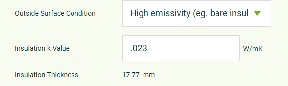

I don't think that the calculator in your reference includes convective heat transfer resistance inside and outside the insulation.
Change input to
and to
indicates it does, or am I mistaken ?

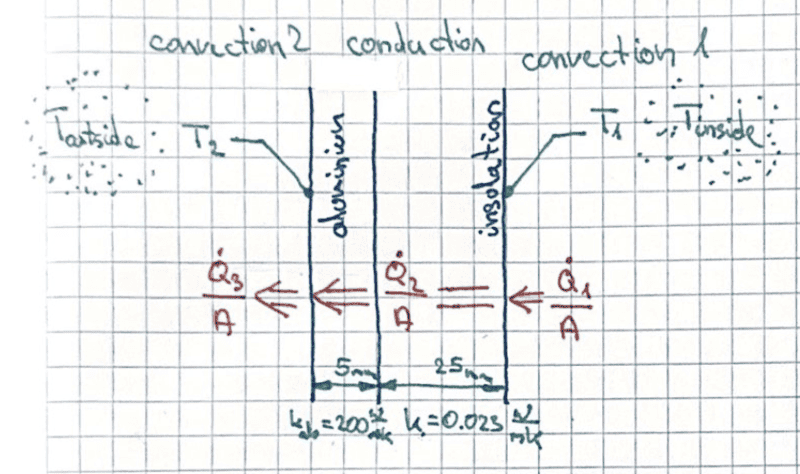

Thanks for the tip - I've tried to solve the problem and my equations give me somewhat sensible results but they don't match the result from the calculator. I'll try to walk you through it briefly.
The diagram for the problem:
For thermal equilibrium, I'm assuming that heat flux in and outside the panel must be equal so that temperatures remain constant.
##\dot Q_1 = \dot Q_2 = \dot Q_3## because ##T_1,T_2, T_{outside}, T_{inside} = constant##
For the worst-case scenario, ##\dot Q_1## can be omitted and simply
##T_1 = T_{inside}##
For Conduction through the insulation (##\dot Q_2##):
##\frac {\dot Q_2}{A} = \frac {T_1-T_2}{\frac {t_{ins}}{k_{ins}}}##
I'm ignoring the aluminium panel as it has a negligible thermal resistance.
For Convection between insulation and outside ambient air (##\dot Q_3##):
##\frac {\dot Q_3}{A} = h_3(T_2-T_{outside})##
So since:
##\dot Q_2 = \dot Q_3##
Then:
##\frac {T_1-T_2}{\frac {t_{ins}}{k_{ins}}} = h_3(T_2-T_{outside})##
And from that I come up with this solution for thickness:
##t_{ins} = \frac {k_{ins}(T_1-T_2)}{h_3(T_2-T_{out})}##
But when I plug in the same input from the calculator and h = 22, the result is thickness = 8.5mm instead 22.48 as it should be.
Any advice on what I'm doing wrong? :)
Let ##T_3## be the temperature between the aluminum and the insulation. Then, $$T_{outside}-T_1=\frac{q}{h_{outside}}$$
$$T_1-T_3=q\frac{b_{insulation}}{k_{insulation}}$$$$T_3-T_2=q\frac{b_{aluminum}}{k_{aluminum}}$$$$T_2-T_{inside}=\frac{q}{h_{inside}}$$. Add these equations together to eliminate T1, T2, and T3
