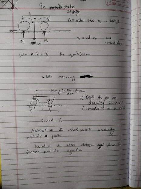

I was trying to figure out how this works. If we look at FBD of this. and balancing the center of mass on one wheel at high speed. Doest seems right. I have tried to figure it out. But was to avail.

I am trying to understand the dynamics of performing a wheelie. Please correct me if I am wrong. And help me out

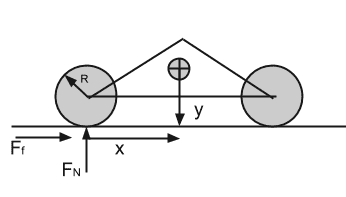

Think of it from the point of moments being applied on the free body.
One moment is because of the graviational force multiplied by the perpendicular distance to the rear wheel contact, as that is the fulcrum about which the bike is rotating.
The second moment is because of the frictinoal force, multiplied by the rear wheel radius. Or you can take this as the force the bike applies on the rear axle multiplied by the rear wheel radius, which is the perpendicualr distance from the force to the same fulcrum mentioned before.
A third moment will be because of the force exerted by the front wheel on the ground, multiplied with the distance between the wheels in contact.
Try to construct the free body diagram from this.
So when the second moment is greater than the first one, there will be a net moment that will make the front of the bike rise up. Here the third moment will not matter because when the front is rising up, the force exerted by the front wheel will be zero.
When the first moment is greater than the second, then the third moment will come to play and the net moment will be zero, causing no rotation of the body.
Does this make sense @mike_241 ?

mike_241 said:
I am trying to understand the dynamics of performing a wheelie. Please correct me if I am wrong. And help me outView attachment 328958
Your FBD is wrong (and you do NOT need two: one when it is moving and one at rest).
Lifting the front wheel up will happen when you are accelerating. So put the forces involved with acceleration on your FBD in addition to the ones related to the weight. (A vehicle can accelerate even if its velocity is zero.)

Initiating a wheelie is possible because the combined center of mass of rider and machine is vertically located way higher than the contact patch of the rear wheel and pavement or dirt.
As the contact patch is forced to accelerate forward by the engine, that center of mass has inertia or resistance (both linear and rotational) to be moved in that forward direction and to be rotated higher up.
