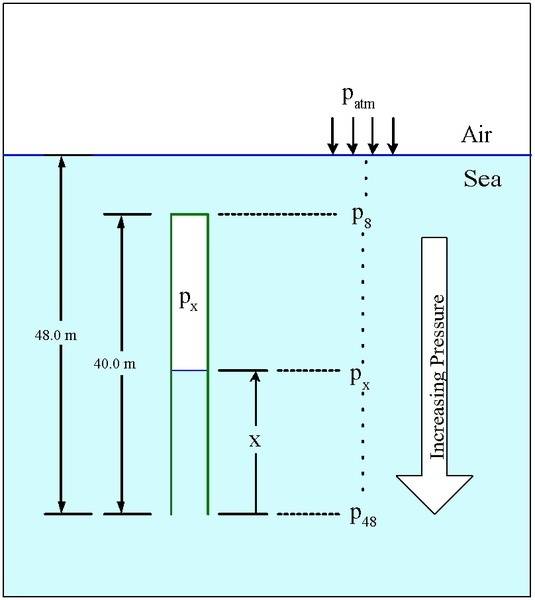

Pressure changes with depth in the fluid. The air inside the tube will compress until the its pressure matches the water pressure at the depth of the air/fluid boundary inside the tube. Here's a diagram to help you think about it:
The tube is 48m long, not 40m, so the closed end is at the surface.
Other than that, nice diagram :approve:
Huh. Could've sworn I saw 40m for the length :redface: Ah well, the diagram should still serve to identify the relevant physical concepts. Thanks haruspex.
Start thinking about using the ideal gas law for the air trapped in the tube. If the new length of the trapped air is L, and it started off with a length of 48 m, what is the new pressure? What is the water pressure at the bottom of the tube? What is the water pressure at the interface with the air if the height of the column of water in the tube is 48 - L?

Not really, though I suppose you could iterate that way.
The trouble is that, as gneill showed in the diagram, the final pressure in the trapped air is equal to the water pressure at its new base. You computed the pressure at depth 48m, which will be too much.
Let the final length of the trapped air column be h. (This will work out a little more simply then using x = 48-h.) What is the water pressure at at depth? What will the air pressure be having been compressed from length 48m to length h?
