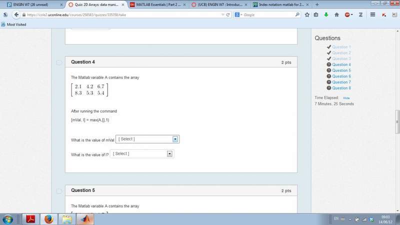

Code:
A = [2.1, 4.2, 6.7; 8.3, 5.3, 5.4]
A =
    2.1000    4.2000    6.7000
    8.3000    5.3000    5.4000
Code:
[mVal, I] = max(A,[],1)
mVal =
    8.3000    5.3000    6.7000I =
     2     2     1
I don't understand what max(A,[],1) is doing. The mVal is a maximum values. The I is the index of those maximum values. What is the [] and 1 for?

I think the [] is just a placeholder for the second argument. There are 3 versions of max, with 1, 2, and 3 arguments.
