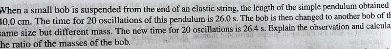

i have attached the sample ans here.
hand written photo is my working.
since the question doesn't same string . so i assume it's a same spring. so i would get t is directly propotional to sqrt root (m). is my concept wrong?

The question states that the string is elastic - so what effect would different masses of bob have on the string?
Note: the question asks you to explain the effect - your working is maths only, an explanation would have words in it.

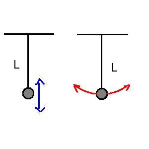

You assumed the bob vibrating vertically (first picture), while the problem speaks about a pendulum, the bob moving along an arc of circle about the equilibrium point (second picture). As it is an elastic string, the bob can move in a quite complicated way. If it is initially in rest, and you pull a little bit vertically, it performs vertical SHM with ω=√(k/m). That is not pendulum motion.
If you kick the bob horizontally, it moves like a pendulum in the vertical plane. In case the deviation from vertical is very small, the length of the string does not change appreciably. For that motion, ω=√(g/l), the same as that of a "normal" pendulum. You need to use that formula, keeping in mind, that the length of the pendulum is not proportional to m. The string stretches because of the weigth of the bob, and the change of the length is proportional to the mass.
