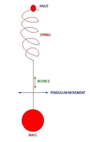

Hi,
I just wonder what happens if a pendulum is attached to a pivot point via a flexible spring, and the spring is:
1 Not damped
2 Partially damped
Will the pendulum stop earlier, or will it sustain as long as a pendulum with no spring attached to it?
Vidar
Maybe I should add a drawing. Here it is:

I tested this but I could not notice any major difference between them. It should be because the damped spring is actually friction which is energy loss. Maybe I did not damp it enough, because the energy loss should be taken from somewhere. It cannot show up from nothing.

The springy pendulum is a kind of coupled oscillator - a mass-on-a-spring and a regular swinging pendulum. The two systems can exchange energy in some setups so you almost alternate between bouncy and swingy motions.
If the coupling is weak you will get one kind of motion dominating.
However, you can usually get smooth motion if you are very careful how you displace the bob. For chaotic motion try driving the pendulum with a random impulse.
Real pendulums also have a torsional oscillation as the bob twists as it moves. It is also difficult to get it to swing exactly in a line so there will be a slight lateral swing as well.
