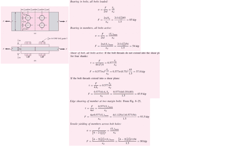

What is the reasoning behind the different forms of F in bolted joint equations?
In summary: So since each of the shear planes has a shear force F/4, and an area πd2/4 and since there are four bolts,so ## \frac{\frac{F}{4}}{4 ( \pi \frac{d^2}{4})} ## = ##\frac{F}{4 \pi d^2}##but that doesn't agree with the equation in the question, which says that F/2 is transmitted by each of the splice plates.The equation in the question says that F/2 is transmitted
minoroctave
32
I am having trouble understanding the F used in these equations. Is it supposed to be the force F shown on the left, or is it F/2 or F/4?
It must surely be the F in the diagram. This is shared over two bolts each side, so I expect to see F/2 in the equations. And indeed that is what we do see.

I'm saying each bolt gets F/2, but I can't comment beyond that without knowing what t and d represent.
for the bearing stress equations, d is supposed to be the bolts major diameter and t is the thickness of the thinnest plate
Ok,then it is the same F as in the diagram. Each bolt takes half the load, F/2. To get the bearing stress, divide by the area, td.
To get the shear stress, you have to consider that there are two shear planes for each bolt, one at each side of the central plate (so distance t apart). Each of those has a shear force F/4, and an area πd2/4.

for the shear equations, it says the area is supposed to be the total cross sectional area of all the bolts in the group. So since each of the shear planes has a shear force F/4, and an area πd2/4 and since there are four bolts,
but that doesn't agree with the equation in the image
You are dividing by 4 twice over.
You can think of it in many different ways:
- a total force of F spread over four (half) bolts with a total area of πd2
- a force of F/2 on each of two bolts, each with a shear plane area of πd2/2
- a force of F/4 on each of four shear planes, each with an area of πd2/4
All lead to the same answer.

thanks. also, for bearing stress in the members, what is the reason for it being ##\frac{F}{2dt}## ? In the solutions, I see ##\frac{\frac{F}{4}}{\frac{t}{2} d} = \frac{F}{2td}## , but don't know why
