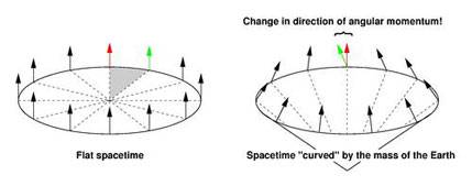

Kip Thorne seems to like the cone explanation:
http://einstein.stanford.edu/SPACETIME/spacetime4.html#geodetic_effect

Kip Thorne is explaining geodetic precession in the quoted example. In spite of the similarity of the names, it doesn't mean he is explaining the precession of Mercury's orbit via this mechanism.

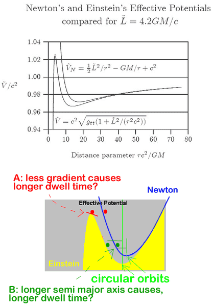

I'm trying to come up with an intuitive, yet correct explanation based on the effective potential. The problem is that in the links I posted are not very clear about what "causes" the "extra dwell time" at the inner part.
I found a plot in the this old thread:
https://www.physicsforums.com/showthread.php?t=224397
And sketched two "reasons" for the "extra dwell time" below it:
What is a better explanation? A, B, both or something else?
