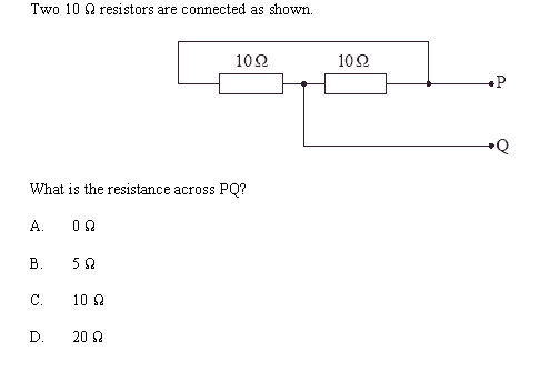

What is the resistance between two resistors?
30 replies · 4K views
ImpCat
25
R=V/I
Would it be 10ohms? Since PQ is between two 10ohms resistor.

Are the two resistors in parallel or series or some other configuration?
Hint -- what do parallel resistors share? :smile:
They have the same voltage across both resistors? But the voltage across the two resistors is after the voltage has been reduced by the first resistor right? I still am not seeing how I can solve the equation with just these information. :<
They are on purpose trying to make the question confusing. one terminal goes to one side of each resistor, and the other terminal goes to the other side of each resistor. Are the resistors in parallel?
Try colouring all wires connected to "P" one colour and all wires connected to "Q" another colour.

Has anyone told you to redraw the circuit, using as many trials as is necessary, until you can draw them unequivocally as a pair of resistors in either (a) a series arrangement, or (b) a parallel arangement. It must be one or the other.

The question being addressed is: with what single resistor could you replace this two resistor arrangement so that the current between P and Q would be unchanged (obviously when some voltage is applied between P and Q).

You have not yet determined whether the two resistors are in a parallel arrangement, or are in series?
How would you recognize a parallel arrangement? How would you recognize a series arrangement?

There are no unknown resistors here. There are two known resistors, they are known to be 10Ω each. There are no more resistors; there are just two resistors. There are not 3 resistors, and not 4 resistors. Just two!

I realize that, I just treated PQ as a resistor-which I realize is a big mistake. But if I don't treat it as a resistor, how would I find the resistance between PQ?
There is no additional unshown resistance between P and Q, though it wouldn't make any difference if there were. All we are interested in doing in this exercise is replacing what you can see with its equivalent.

I see now, thanks for your help! The answer would then be B. It's just that the phrase "Resistance between PQ" confused me. Like how can you have a resistance between two points, don't you need a sort of conductor?

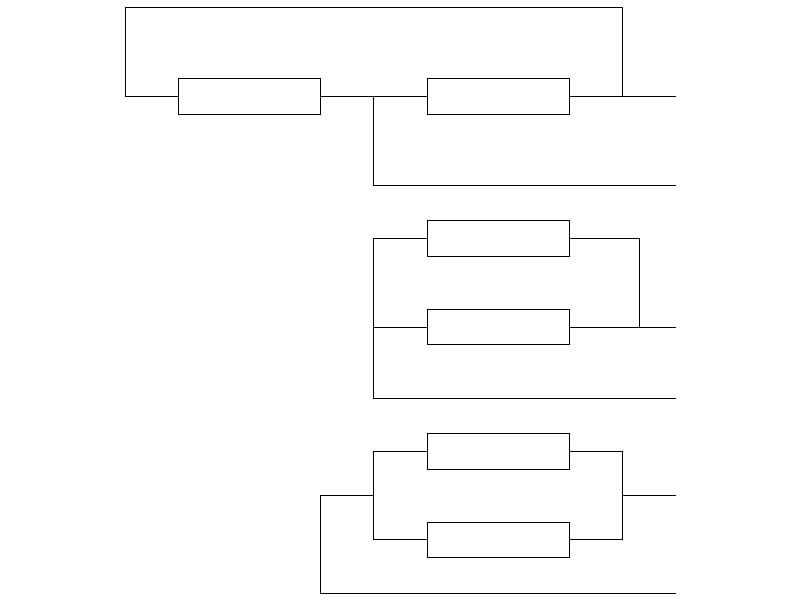

Nidum said:
Perhaps this picture will help you understand the problem more clearly . It just shows the same circuit drawn in different ways .
ATTACH=full 109845[/ATTACH]
Thanks for the picture, really helped my understanding :smile:

And to confirm to an examiner that B is not just a guess, how do you justify giving that as the answer?

By treating it as a parallel circuit so 1/10 + 1/10 = 1/r
r=5
r=5
Well, an examiner could ask how did you recognize it to be a parallel arrangement, and not a series arrangement of two 10 Ω resistors?
I would reply that in a series circuit, there would only be one path for electrons to flow. Whereas in this particular circuit diagram, there are two paths for the current to flow toward the resistors-as seen by the wire connecting the sides of the resistor and in between the resistors. As such this is a parallel arrangement, not a series arrangement.
