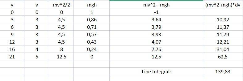

Thank you for the replies. In one dimension, the usual first problem is a ball dropping vertically from a height [here]. The Euler-Lagrange equation leads to a = -g, which once double integrated traces the position path of the ball.
I am still confused if the Lagrangian depends only the final position path taken, or is it dependent on the speed/motion used in traversing this path.
In the 1 dimensional case above, I have calculated the integral L for a ball dropping with a = -g.

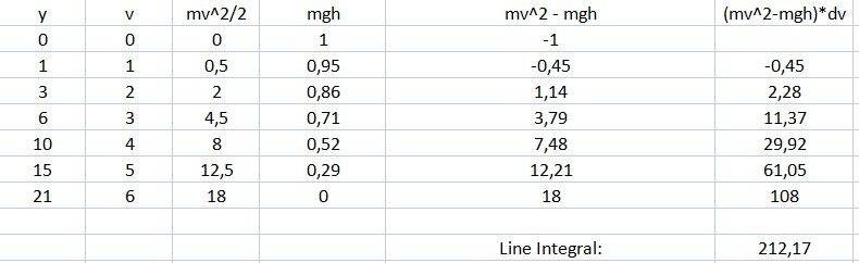

I have also calculated alternatively a ball dropping the same height (ie. exact position trajectory) using a different velocity distribution.
I have tried to explain this to no avail. Could you explain why the alternative motion in the second case gets a lower integral L=139 value than the Newton's motion in the first case L=212. Why is this second motion not chosen over the first motion, because the integral value L is lower than the first, according to the least action principle?
In your message with two images of spreadsheet calculation: it says in the fifth column: 'line integral'
Is that a typo or does your spreadsheet actually evaluate the line integral?
Hamilton's action is the area integral.

In the spreadsheet the quantity is total sum of all values above that box. Is this the discrete version of the Lagrangian, or something different? How to define area integral for 1 dimension problem?
In a diagram the values ##E_k##, ##E_p## and ##(E_k - E_p)## can be plotted as functions of time.
Comparison:
Let's say you want to evaluate the area between a parabola and the x-axis, from x=0 to x=1
For a diagram with 'x' as the horizontal coordinate, and 'y' for the vertical coordinate the corresponding function is: ## y = x^2 ##
The integral: ## \int_0^1 x^2 dx ##When you have a trajectory as a function of time you can use that to plot the value of the Lagrangian ##(E_k - E_p)## as a function of time. In such a plot you use time as the horizontal coordinate, and the value you want to plot as the vertical coordinate
You can then evaluate the area between the horizontal line at vertical coordinate zero, and the plot of the Lagrangian, from time coordinate ##t_1## to ##t_2##

@Cleonis I'm scratching my head too. My mental block seems to be that I have obtained a lower L value (in #4) by using a constant velocity ##v = \sqrt {mgh_{mid} - m} / 2## motion on the same path, compared to the Newtonian accelerated motion. Because L depends on v, thus v can be toyed with to minimize the integral further. Could you reproduce the lower L value, or help show the calculation error please?
You haven't understood the idea of minimising the action. The end points in space and time are fixed and you minimise the action with those constraints.
If you take the case of motion with no external force, then you are looking at motion from point ##A##, which we can take to be the origin at ##t = 0##, to point ##B## at some time ##t = T##. We can take ##B## to be the point ##(X, 0, 0)##.
We then minimise the action under these constraints and find the straight line path at constant velocity, namely ##\frac X T##.
No, you haven’t. Your expression does not even make dimensional sense. You cannot subtract a mass from an energy.
