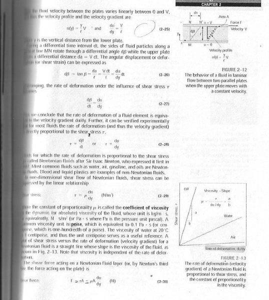

why the velocity gradient is given by the formula u(y) = y(V) / l , why not V / l ?
Where does it say so ?
The equation you wrote is for the velocity, not the velocity gradient. What do you get if you differentiate your equation for u with respect to y?
