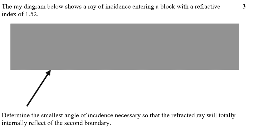

The ray diagram below shows a ray of incidence entering a block with a refractive index of 1.52. Determine the smallest angle of incidence necessary so that the refracted ray will totally internally reflect off the second boundary.
So I figure the answer is 90 degrees...but I don't feel that is what they are after?

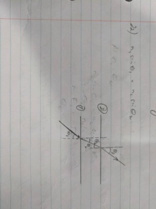

see reasoning posted 1 hr ago; 90 degrees refracted angle is the condition for TIR to begin
see my working... theta 1 = theta 3, so for theta 3 to equal 90, theta 1 must also...right?

But that is not what the problem is asking of you. You need to find the smallest Θ1 that on the second boundary the ray doesn't exist the block (i.e. is boundary internaly reflected). So Θ2 is essentialy the total internal reflection critical angle. Again, compute the total internal reflection critical angle and by snell's law you will find the smallest Θ1.

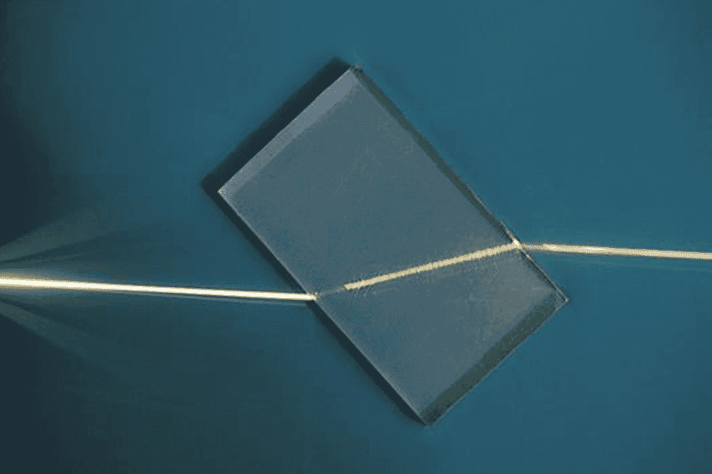

case in point...how do you get TIR to occur by varying the bottom incident beam angle? It doesn't look possible to me?

No. Read the problem again. It says total internal reflection of the second boundary. You cannot have total internal reflection outside the block because air has a lower index of refraction than the block. The light enters the block at the angle we are seeking so it will boundary internaly reflect inside the block and never leave it.

Exactly...and I am saying there is no angle for which this is true..you just have to look at the geometry to see that (2 parallel lines ie air/block incident ray parallel to block/air refracted ray). You don't need any Snells law calculations to see that.
The question does not demand that the light ray never leave the block. It requires that the ray which is refracted upon entry at the lower face is then totally reflected at the upper face. There is no requirement for total internal reflection of the reflected ray as it strikes the lower face on the rebound.
Edit: However, I see the point. There is no such angle. Symmetry demands that the ray is deflected toward the upper face by enough that TIR can never occur.

That said, I believe (as @jbriggs444 noted) the point is that the symmetry of the situation is such that the angle of incidence at the second surface is equal to the angle of refraction at the second surface. Thus it's impossible to get total internal reflection in this case, because the angle of incidence at the second surface would need to exceed the critical angle and it cannot because the angle of refraction at the first surface is less than or equal to the critical angle. The only way to get total internal reflection is to inject light into one of the side faces.
