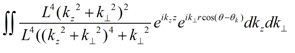

I have a tricky integral of the form
∫∫[(L^4)((k_z)^2 + (k_p)^2)^2]/[(L^4)((k_z)^2 + (k_p)^2))^4 + (k_p)^2] * e^(i*k_z*z)*e^(i*k_p*cos(θ-θ_k))*dk_z*dk_p
which is arising in an inverse Fourier transform. I know that integrals somewhat like this appear in smectic liquid crystals but I can't find a solution offhand. It's also one of those things where Mathematica churns and spits out some unreadable nonsense.
Any ideas? No numerics please this is in relation to a Green's fn problem so there is guaranteed to be an analytic solution. Also if anyone thinks this could somehow be simplified by the convolution theorem I'm all ears.
-Ski

I got an idea. Why not make the notation easier to read? Looks like you have:
[tex]\iint \frac{(x^2+y^2)^2}{a(x^2+y^2)^4+y^2}e^{ixz}e^{iyk}dxdy[/tex]
Is that correct?
Ok, Mathematica does return a single integral expression for that in terms of RootSums. It's completely readable if you know how to interpret the RootSums although it is extremely complex. If that can help you, I could explain how to interpret them.
Yes, I could use a different explanation for the RootSums, the one Mathematica gives doesn't help me much. The goal is to reduce this to as simple a form as possible because it still needs to be expressed as part of a larger vector field and differentiated, etc., before it will be useful in my research.
Let's look at a simple one:
[tex] \begin{align*}<br /> \int \frac{1}{x^5+11 x+1}dx &=<br /> -\text{RootSum}\left[1+11 \text{$\#$1}+\text{$\#$1}^5\&,\frac{\text{Log}[1-\text{$\#$1}]}{11+5 \text{$\#$1}^4}\&\right]\\ &+\text{RootSum}\left[1+11 \text{$\#$1}+\text{$\#$1}^5\&,\frac{\text{Log}[3-\text{$\#$1}]}{11+5 \text{$\#$1}^4}\&\right]<br /> \label{eq:}<br /> \end{align*}[/tex]
The RootSum represents a sum of a function over the zeros of a polynomial. The syntax uses "pure functions" using the "#1" as place holders for the variable. So the construct:
1+11#1+#1^5
is to be interpreted as z^5+11z+1 and we want to compute the zeros of z^5+11z+1=0 and then substitute those zeros into the second argument of the RootSum which is also a pure function, and sum them. For example, the first one is:
[tex]\frac{\text{Log}[1-\text{$\#$1}]}{11+5 \text{$\#$1}^4}[/tex]
So say the first root is z_0, then the first term of the sum would be:
[tex]\frac{\log(1-z_0)}{11+5 z_0^4}[/tex]
We can write in general:
[tex]\text{RootSum}\left[1+11 \text{$\#$1}+\text{$\#$1}^5\&,\frac{\text{Log}[1-\text{$\#$1}]}{11+5 \text{$\#$1}^4}\&\right]=\sum_{z^5+11z+1=0} \frac{\log(1-z_n)}{11+5 z_n^4}[/tex]
Here's a Mathematica function you can use if you wish which accepts a RootSum and returns the sum of the RootSum terms:

Ok, that makes sense. A ridiculous amount of terms, but that happens sometimes. Thanks!
