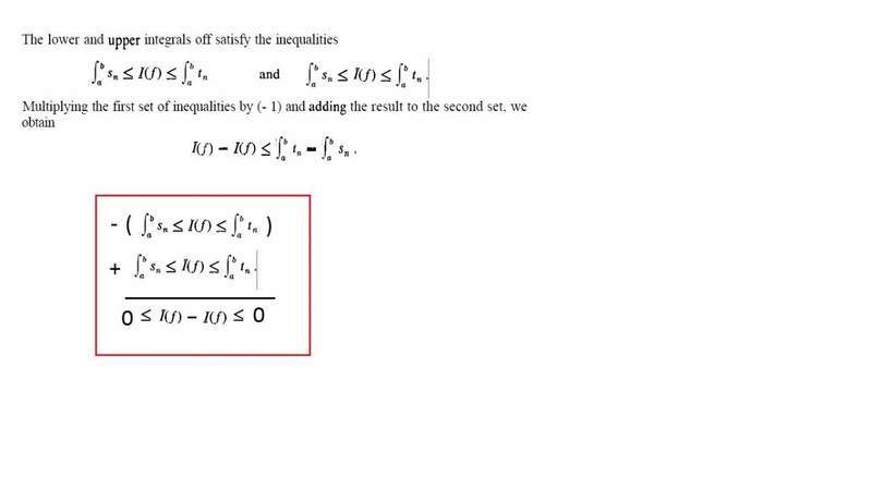

I posted the paragraph with the inequality where I am confused...
I also added a portion i highlighted in red
The text in the image is not very clear. One of the 'I's appears to have a line on the bottom, the other has the line on top.
Regardless, the portion in the red box looks nonsensical. Everything before that makes sense.
Let the s integral be represented by S, and the t integral be represented by T. Let's call the first I with the bar on the bottom A and the second I with the bar on top B.
So the inequalities are:
[itex]S \leq A \leq T[/itex] ---(1)
and [itex]S \leq B \leq T[/itex] ---(2)
Take (-1) times inequality 1. Remember to reverse all the signs:
[itex]-S \geq -A \geq -T[/itex]
Reverse the order of the terms (just write it backward):
[itex]-T \leq -A \leq -S[/itex] ---(3)
Add (3) to (2):
[itex]S-T \leq B-A \leq T-S[/itex]
and the latter half of that is what's given in the attachment (before the red box).
What's in the red box looks wrong as I said - was that in the original?
