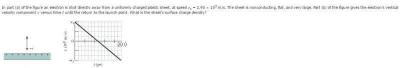

E=σ/(2Eo)
σ=2Eoma/e
a=Δv/Δt
So doing my best to read the velocity over time graph I came up with
Δv/Δt=(-2E5m/s)/(10E-12s)=-2E17 m/s/s
σ=2Eoma/e
=2(8.99E-9C)(9.109E-31kg)(-2E17m/s/s)/(1.6022E-19)
=-0.020444 C/m^2
but by the first illustration you can see that the sheet has a positive charge so the charge density should be:
0.020444 C/m^2 <----this final answer was incorrect

Okay let's try this again.
A=(2*-2.9E5m/s)/(2E-11s)
=-2.9E16
So using that correct value along with the appropriate value for the charge of an electron:
2(8.99E9C)(9.109E-31kg)(-2.9E16)/(-1.6022E-19)
2.964E15 C/m^2

Let's try this again
The acceleration according to the graph is 2*(-2.9E5m/s)/2E-11= -2.9E16 m/s/s
σ=2Eoma/e
=2*(8.855E-12)(9.109E-31)(-2.9E16)/(-1.6022E-19)
=3E-6 C/m^2

You can either use Coulomb's constant, but as a divisor here, or the permittivity as a multiplier. But in the second you need a 4π too.
Edit: no that's wrong... Let me check.
Edit2: I should have written, you can either divide by Coulomb's constant and by 4π, or multiply by the permittivity, as you did. Anyway, TSny seems to have identified the remaining issue.

Looks good. But the data was given to 3 significant figures.
