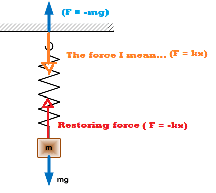

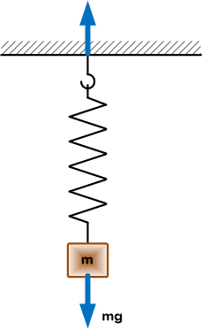

Good afternoon,
I have some doubts about the tension force suffered by a spring to which a mass is hung and which is making a simple vertical armoin movement. My doubt lies in the fact that at the bottom of the pier (where the mass hangs), the spring exerts the restoring force that is given by Hooke's Law. However, at the top of the dock (at the point where it is fixed), what is the tension force that appears? Is it the same as the restoring force but in the opposite direction?
Thanks in advance
Ask yourself what it is in equilibrium: the restoring force is zero (at least that is my perception of a restoring force ...) but the suspendion point has to exert an upward force !
And when the mass is oscillating up and down, you first ask if the spring is massless. If it is, a simple force balance tells you the answer to your question !

What did the sensor measure ? The force exerted by the suspension, or thte force exerted by the spring on the suspension point ?

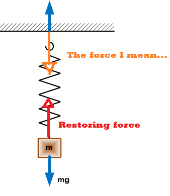

Thanks again, the sensor mediates the force exerted by the spring on the suspension. If we think about it slowly, it makes sense that this force goes in the opposite direction than the restoring force given by Hooke's Law, but I don't know very well how to explain it from a formal point of view ...I enclose the same diagram you show in your response with the force to which I refer to...

Okay, thank you very much, I think I understand something better now, what I have not seen is the reason why the forces have to balance, after all the lower part of the pier if it is suffering an acceleration .. .
Is the diagram that I attached with the value of the different forces correct?

If the mass m is oscillating, then so is the center of mass of the spring. So if you don't assume a mass-less spring, the forces on the spring are not balanced.
It's not clear which force acts on which body.
It's not clear if the spring has any mass.
The red force is missing its Newtons 3rd Law partner.
The 2 forces at the upper attachment must satisfy Newtons 3rd Law (equal but opposite), but in a dynamic situation there is no reason to assume -mg acting at the ceiling.

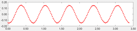

Thanks again, the mass of the pier is not zero, but if it is very small compared to the masses that are placed on the pier, I still don't quite understand the reason why the force exerted by the spring on the surface is equal to the restoring force given by Hooke's Law, but in the opposite direction ...
I have tested it experimentally both in the static and dynamic case and in both cases the same happens (attached a graph obtained from force and position sensors)
This is the position:
This is the force:
Hm, that's not very surprising since from
$$\ddot{x}=-\omega^2 x$$
the general solution is
$$x(t)=x_0 \cos(\omega t) + \frac{v_0}{\omega} \sin(\omega t),$$
and the force is thus proportional to the elongation,
$$F=m \ddot{x}=-m \omega^2 x.$$
Since the force is in phase (not shifted by ##\pi##, i.e., not with the sign) you obviously measure not the force acting on the body but the reaction force on the suspension.
