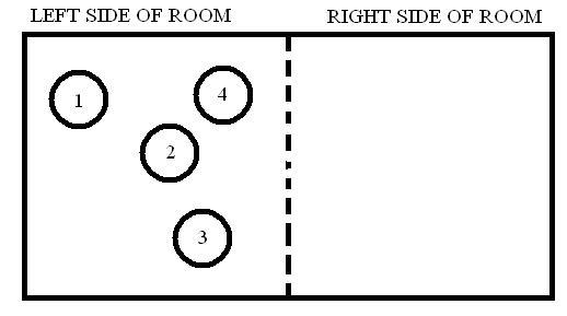

Stat mech says that entropy is basically a measure of the number of ways to arrange a given system.
Can give any examples?
entropy, S, is defined to be: S = k * ln(W)
k is the Boltzmann constant, approximately 1.38*10^-23 J/K
W is the number of ways to arrange the system
in complicated examples W is difficult to calculate (there is an alternative formula). but consider the simple case of arranging 4 particles in a room:
there is only 1 way of arranging all the particles on the left side of the room. hence W = 1. the entropy can be calculated:
S = k * ln(W)
= (1.38*10^-23) * ln(1)
= 0
however, there are 6 ways where two particles are on the left and two particles are on the right (think of arranging 4 people into pairs). hence W = 6. the entropy of this system is:
S = k * ln(W)
= (1.38*10^-23) * ln(6)
= 2.47*10^-23
there are more ways of arranging the particles so half are on one side, than there are ways of arranging all four of the particles to one side. the most probable state as it turns out, is one in which we have half the particles on one side, and this is called the equilibrium state. entropy is always a maximum at equilibrium, and thermodynamic systems tend to equilibrium. this explains why particles fill up the entire room rather than just go to one side.

But doesn't that depend on where I want to put the division? Let us suppose I divide the box into 3 parts, left, right and middle. Then one of the four particles lying on the left half of your box may be situated in the middle of my box. If I go on increasing the number of divisions I will increase the number of ways to arrange the system thus reaching infinity. (Please I am not trying to simply contradict. Sometimes it is expected of me to understand certain certain obvious things but usually I don't. So please bear with me)

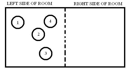

Here is something I posted a while back about entropy:
Kevin_Axion said:
Entropy is the following, (this analogy derives for Brian Greene's book The Fabric of the Cosmos) say you have the book War and Peace by Leo Tolstoy the book is 1475 pages long. You have the ordered state, which is sequential pages, 1 through 1475, you can call this state [tex]\varphi[/tex]. Now you take the state [tex]\varphi[/tex] or the book of pages and throw it in the air. Now it is clear that [tex]\varphi[/tex] becomes disordered, so let's call these disordered states [tex]\zeta[/tex] . Now if you throw it unendingly it becomes clear that the amount of disordered states [tex]\zeta[/tex] is far greater than the one ordered/sequential state [tex]\varphi[/tex]. Therefore we can say [tex]\varphi[/tex] < [tex]\zeta[/tex]. This is true because there is one ordered state which is sequential and approximately [tex]10^{500}[/tex] disordered states, I got this number by just approximating the amount Brian Greene said. Disorderd states [tex]\zeta[/tex] can just have 2 pages out of place or 500. Therefore the book began in an ordered state and as it evolved which is the throwing, it will become disordered. Now chaos (or the butterfly effect) has the analogy that say you have a butterfly in Africa. This butterfly flaps its wings and at first it has a very small effect on the air pressure, but over time as the weather system evolves this small pressure system the butterfly created increases exponentially and hence the slight change in initial conditions can cause a hurricane to be formed across the Atlantic. Or at the beginning of the Universe if the expansion rate was slower by a billionth it would have expanded far to quickly for gravity to create a stable super clusters and structure formation. Or if the electromagnetic force was weaker molecules wouldn't form.
Kevin
