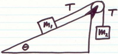

Two blocks are connected over a pulley. The mass of block A is 10 kg and the coefficient of kinetic friction between A and the incline 0.20. Angle [tex]theta[/tex] of the incline is 30 degrees. Block A slides down the incline at constant speed. What is the mass of block B?
Hand-drawn diagram of a block m1 on an incline at angle theta, connected by a rope over a pulley at the top to a hanging block m2, with tension T labelled on both rope segments.
Fs=mgsin[tex]theta[/tex]
Sin[tex]theta[/tex]= Fs/mg
I tried using substition in order to find the second mass, but that route bore no fruit.
9.8 x 10 x sin 30= 49
Fs=49
T- mgsin[tex]theta[/tex]=ma
T-49=ma
T=ma+49
-T+m(subscript 2)g= M(subscript2)a (we substitute t for ma+49)
-(m(subscript 1)a+49)+m(subscript 2)g= M(subscript 2)a
-msub1-49+msub2g=msub2a
all that boils down to is
(9.8m(sub2)-49)/(10+msub2)= a
How exactly am I supposed to find the second mass without knowing the acceleration?
when you found the Fs that was static friction? because the block is under a constant velocity so it is actually kinetic friction.
and also you did 9.8x10xsin30 but you didn't include the frictional constant in there.
Alrighty. But even if I do include the kinetic friction, how would I find a?
well the problem states that Block A (m2) is sliding down at a constant velocity. constant velocity means what type of acceleration?
and if block A has acceleration (a) and we're assuming that the string doesn't stretch what does that say about block B's acceleration?
Constant velocity means no acceleration
And ah, ok :)
yes also your calculation for friction was wrong it should be:
[tex]\mu_kN[/tex]
and you know N as one of the components of mg and you know the downward is mgsintheta
