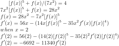

[f(x)]^5 + f(x)/(7x^2)=4
when f(2)=3, calculate f'(2)
Attachment has solution
I am stuck. I don't know if I am right upto there.

I can't see your attachment. But just take the derivative of both sides of the equation and solve for f'(x).
Here is what is in the attachment:
[tex]\left[f(x)\right]^5+ f(x)/7x^2= 4[/tex]
[tex]7x^2\left[f(x)\right]^5+ f(x)= 28x^2[/tex]
[tex]f(x)= 28x^2- 7x^2\left[f(x)\right]^5[/tex]
[tex]f'(x)= 56x- (14x\left[f(x)\right]^5- 35x^2\left[f(x)\right]^4 f'(x))[/tex]
That has a sign wrong- either drop the parentheses or write
[tex]f'(x)= 56x- (14x\left[f(x)\right]^5+ 35x^2\left[f(x)\right]^4 f'(x))[/tex]
when x= 2,
[tex]f'(2)= 56(2)- (14(2)3^6+ 35(4)(3)^4f'(x))[/tex]
[tex]f'(2)= -6692- 11340f'(2)[/tex]
and you now have the sign right!
Now, just solve for f'(2): add 11340f'(2) to both sides and divide by 11341.
(I didn't check your arithmetic!)
