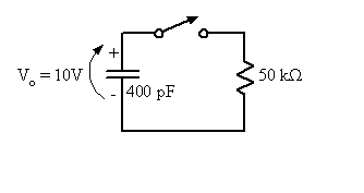

So the circuit looks something like this?
The capacitor is initially charged to 10V and at time t = 0 the switch closes allowing current to start to flow, discharging the capacitor?
The capacitor is fully charged to 10volts.Calculate the voltage drop when the capacitor has been discharging for 10 micro seconds? I thought the switch must be open to allow the capacitor to discharge?
Okay then according to that statement the diagram fits the scenario. You will want to revisit your Attempt at a Solution now. Can you show more of your working?

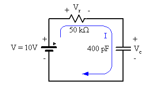

This is how i see this: Voltage is 10v from the battery. The resistor is in series with the capacitor. The capacitor drops 6.065 volts so that must mean the resistor drops 3.935 volts which equates to a total of 10 volts dropped from the battery. But i am confused now! . This would be the case in a steady state circuit but not after 10 micro seconds.
Are you given a circuit diagram for the problem?
If there is a battery in the circuit and all three components form a series circuit, then it likely that the capacitor is meant to start out uncharged (0 V), and charges up over time.
No diagram. The capacitor is set to the maximum 400 pico farad and is charged to 10 volt through a 50k resistor. Determine the voltage drop across the resistor when the capacitor has been discharging for 10 micro seconds. This is the info i have recieved. Hope this helps!
Okay then. So you can justify your equation for Vr by doing KVL around the loop, and your calculations for Vr are correct.
i thought Vr= V- Vc. At this instant of 10 micro seconds the voltage is 6.065 volts so i see the voltage must be 10 - Vc?? This would be the voltage across the resistor?
Right. That's KVL for the loop for that instant in time.
So the voltage drop is 6.065volts because the voltage across the resistor is 3.935 volts??
Just write KVL for the loop using V for the battery voltage, Vr for the potential drop across the resistor and Vc for the potential drop across the capacitor. KVL applies always, at all times. You'll then have the equation that relates all the potential drops around the circuit.
