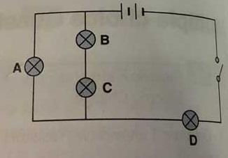

What is the voltage of the bulb D? Given the total voltage supplied by the cells is 4 watts and each bulb is identical and has a resistance of 3 ohms
V=IR
By assuming bulb A,B, and C as a group , their effective resistance would be 2 ohms.
Thus, the effective resistance of the circuit is Effective resistance of bulb A,B,C + resistance of Bulb D = 5 ohms
Hence, the current across the circuit is total voltage supplied / effective resistance of the whole circuit = 4/5 A. Therefore, the voltage of bulb D is 4/5A x 3 ohms = 12/5 W
*forgive me for my random attempt , since my teacher never taught me anything about this part

The units given in the statement of your problem don't make sense.
What is the problem, word for word, as it was given to you?
There is an error here. I think you mean the voltage supplied by the cells is 4 volts
voltage is a measure of the EMF (electromotive force)
w is for watts and it is a measure of energy over time (power) 1 watt = 1 joule for 1 second
