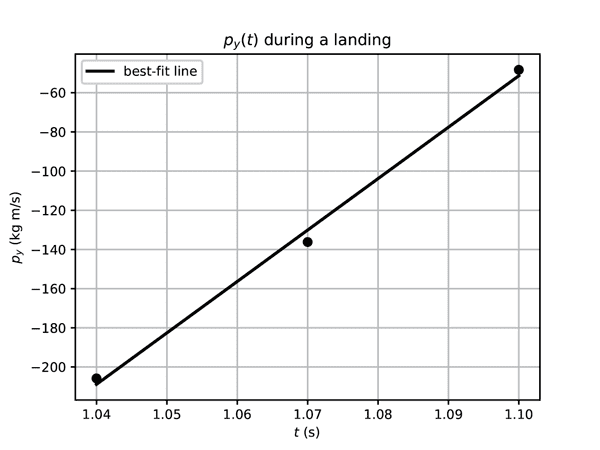

Your lab partner jumps off a lab table and lands on the floor. Using video analysis, you measure her y-velocity during a certain time interval during the collision with the floor and graph 𝑝𝑦(𝑡) as shown below. Her mass is 63 kg. The slope of the best-fit line is 2625 kg·m/s2.

2. What is the y-component of the force by the floor on her during the collision?
3. How does the force by the floor on her during the collision compare to the force by Earth?
|F floor| / |F gravity|
A previous question I got correct was: During this time interval, what is the y-component of the average net force on her? It was just 2625, and I thought question 2 would be the same answer but it wasn't. Not sure what to do.
I'm a bit confused about what's being measured by what here? ##kg\cdot m/s^2## is newtons, but how do you measure force by video analysis? Also, the floor is the Earth for all practical purposes.
Sorry, forgot to include the actual graph.

One question asks for the net. The other question asks for one of the contributions to the net. Can you list the forces that act on her during the collision?

The floor's opposite reaction and gravity? So 2625 and -9.8?

Be careful. One of those numbers is a force. The other is an acceleration.
Being careful in this case might include putting units after your numbers. That could help keep you on the straight and narrow.
Note that 2625 [Newtons] is the net force, not the normal force.

Since gravity is measured in m/s^2 its acceleration then, so the only force would be the 2625 kg*m/s^2? When I put that in it was wrong though

No, you had the right idea in post #5 but you need two forces, not a force and an acceleration.
So I multiply -9.8 by the mass 63 to get 617.4 kg*m/s^2 then subtract that from 2625 to get 2007.6 as the total force

I thought 2625 was the total force. Q2 asks for the force from the floor only.
My bad, so 2007.6 would be just the force from the floor, but that isn't the answer either.

Write the equation relating the two forces to the net force.

2625 kg*m/s^2 = 2007.6 kg*m/s^2 + 617.4 kg*m/s^2
Isn't force a vector?
I forgot about the negative, thanks guys it was 3242
