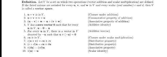

Printed definition of a vector space listing ten axioms: closure under addition and scalar multiplication, commutativity, associativity, zero vector, additive inverse, distributive, and scalar identity properties.
Here is the list of axioms I'm using. I never thought of that. Thanks Ray.
