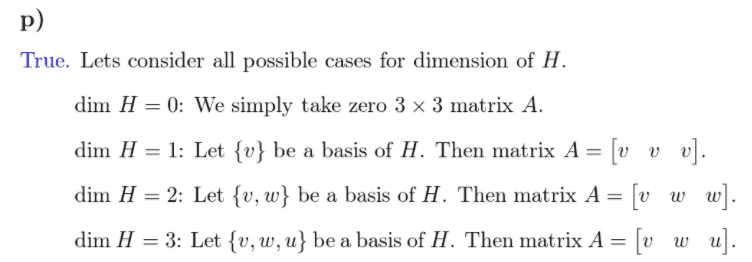

I reached my conclusion based on a similar problem I found on the internett:
Where the solution is given as:
I was only asking because I was curious about the equality between ##col A## and ##H## and what that have to mean.
I assume we are working in the standard basis for ##\mathbb R^n## here. But, that's a minor point.
This isn't so complicated. ##H## is a vector space of some dimension ##m \le n##. ##H## has a basis of ##m## vectors. ##H## is the span of those basis vectors.
Put those vectors into an ##n \times m## matrix. If you want an ##n \times n## matrix, then pad the matrix out with ##n - m## zero vectors - or, as above, with a repetition of one of the basis vectors ##n - m## times.
In any case, the column space of that matrix is the span of the basis vectors of ##H##, which is precisely what ##H## is.
Extending a set of vectors with zero vectors or repetitions of the vectors you already have doesn't affect the span of the set.
