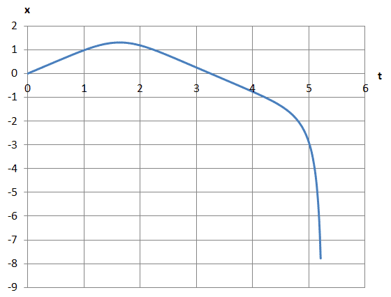

Here's what I found. (Worried)
(Almost) linear movement up, followed by symmetric linear movement down, ending with a near vertical drop.

Do we get the graph by calculating $t$, so the integral, for different values for $x$ on the interval $[0, \sqrt[5]{\frac{15}{4}}]$ ?? (Thinking)
The integral for calculating $t$ only works for the part of the domain where $x(t)$ is invertible, and where $x_0=0$ and $\dot x_0 = 1$.
That is indeed the interval $[0, \sqrt[5]{\frac{15}{4}}]$.
To get the graph for other parts of the domain, we can solve the differential equation again for different boundaries. (Thinking)
Has the movement as you described at the post #7 a specific name?? (Wondering)
Not that I know of.
I can only tell that the first part of the movement is (almost) linear, since the acceleration of the body stays close to zero for a fairly long time.
You can also see this in the speed graph, which shows that the speed remains nearly constant for some time, after which it drops off fairly sharply to zero.
After that it will fall back, and due to the nature of the so called conservative force, it will make the same linear movement back.
You can see this in the speed graph, which shows that it will make the same movement, but in reverse. (Mmm)
