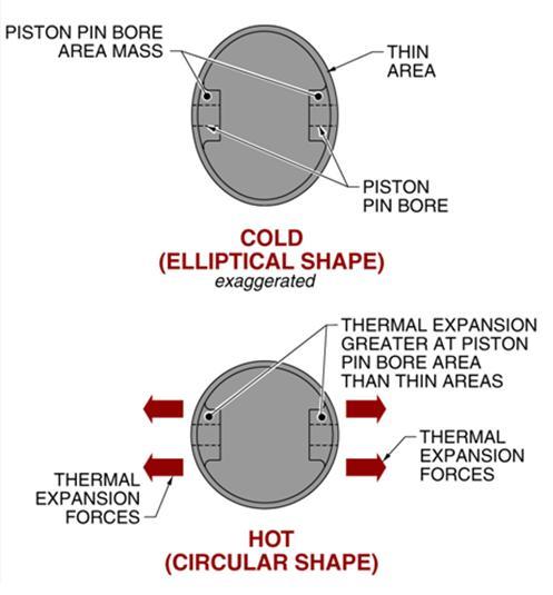

Ranger Mike said:
Pistons are not round but oval. This is because when at operating temperature the top of the piston where the piston rings are located is now Round due to thermal expansion. That time period from cold start to proper operating temperature is where all the wear happens.
Over time the piston will wear the cylinder into an oval shape. This is why you must re-bore cylinders in the engine blocks that have many miles on them.

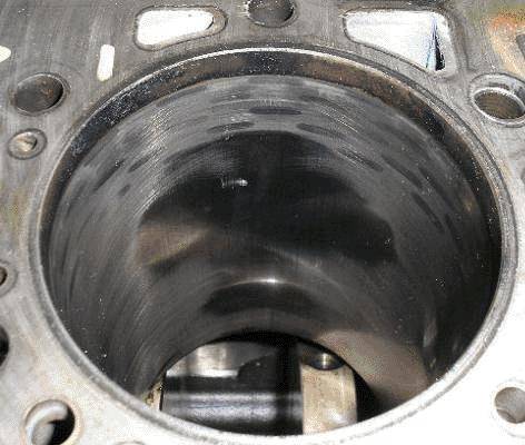

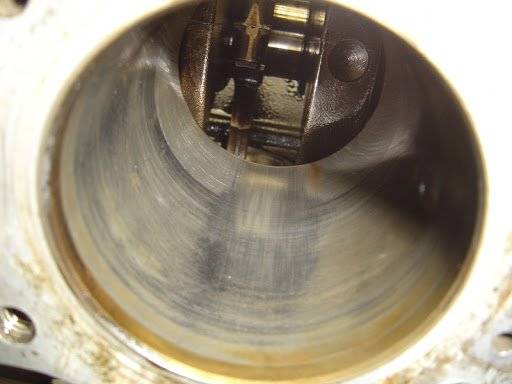

Even if the pistons is oval when cold that does not mean that the piston rings are? The piston rings conform to the cylinder walls, not the piston shape right? So i don't understand how cylinders can wear to a oval shape unless the pistons them self are rubbing against the cylinder (and i guess the piston skirts do that to a certain extent but that is not because of the cold shape of the piston).
pistons do wear the cylinder very much in the direction of piston thrust. Usually 90 degrees from crankshaft center line. Piston skirt helps but over time they will wear.
But what has that have to do with the cold shape of the piston? Is not that because of the side forces form the crankshaft and connecting rods (and the piston skirts rubbing)?
the piston is oval in a cold state. When the piston iswarmed to operating temperature the shape is ROUND to provide maximum sealing of combution chamber and this is most effective shape to transfer the linear combustion power to the crankshaft and covert to rotary power.
It's the piston rings that does the sealing, not the piston shape. And the piston rings float in the piston ring groves. So the rings take the cylinder shape, not the piston shape.
And my question is still how do you come to the conclusion that the shape of the piston when it is cold is what causes the oval wear to the cylinder?
Ranger Mike said:
i never said the oval shape of the piston causes oval wear to the cylinder.
This is a quote of you and what i replied to:
Ranger Mike said:
Piston wear occurs most during start up. The engine is cold and oil has drained off the cylinder wall surface. When you cold start you do in fact have aluminum to iron rubbing. This causes wear on the es surfaces. Pistons are not round but oval. This is because when at operating temperature the top of the piston where the piston rings are located is now Round due to thermal expansion. That time period from cold start to proper operating temperature is where all the wear happens.
How can i interpret this in any other way than that you are implying that the oval shape of the pistons when they are cold is what causes the oval wear of the cylinder?
If not why are you even mentoning the pistons cold shape in a comment about cylinder wear?
you can interpert this any way you want. Not my problem! as i said, i never stated oval shape of the pistons when they are cold is the cause of oval wear. You mistakenly assumed this for some reason.
Piston thrust causes the cylinder wear during warm up.
It is coincidence that ovality is common wear pattern and is the cold state of the piston. I mention this because the orgional post asked for parameters to be considered for max life engine design. If you designed and engine with a round piston it would not last ten minutes.
