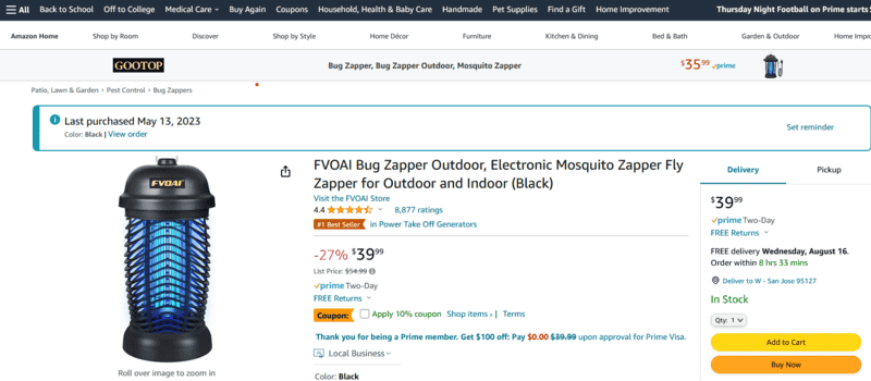

Arceus said:
hello, I would like to have an insect trap, but those on sale that use uv rays (which are the best traps) cost a lot, that's why I want to build a trap myself, I only need 1-2 100 watt uvA tubes and all the electrical accessories to make it turn on, only this nothing exceptional
What kind of insect trap? It only uses UV light to trap flying insects somehow? Or do you intend on using the UV light to attract them, and then a High Voltage (HV) grid to vaporize them? I have the latter type of flying insect trap, which uses about a 40W UV bulb as the attractant, and HV to zap them. I think it cost $30 from Amazon...
yes ok, the traps for sale cost a lot, and therefore I would like to build one myself. for the electrified grid there is no problem, as soon as they rest on the tube I catch them and kill them. i just want to build the system to light the tube, 40 Watt tubes are fine, i need two, could you give me some links? and that they are uvA because they are less dangerous. and then the fact of how to turn them on, do you need the starter and the reactor like neon tubes?
No they don't cost a lot. Here is the one I bought, it looks like it's now $40. That is not expensive.
You need experience with AC Mains projects and the associated safety rules to do this project, and you need to know how to interface with a ballast. You will spend at least as much money if not more than just buying a pre-built unit, and you will expose yourself to AC Mains hazards (shock, fire). This thread is now closed.
