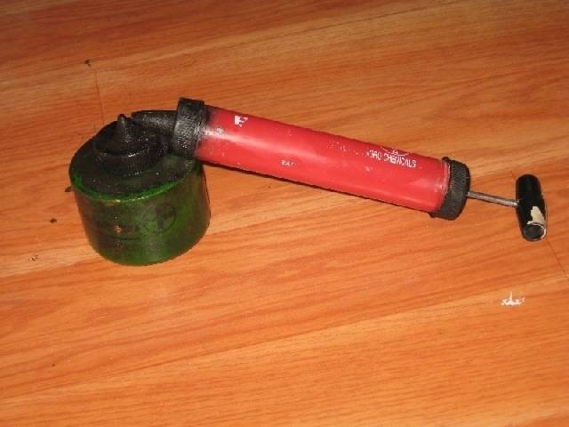

What pump is this and how does it work.

x3qt0r
33
Kindly check the attachment for the picture of the spray pump.
Please link me to the thread/post if this is already discussed elsewhere on the forum.
Is the working of this pump has anything to do with vapor pressure?
Thanks in advance for any help.

updated reply - You're picture resembles a "flit gun", although the pump looks more like a calking dispenser because the outlet hole appears to be too large. These were mostly used for insecticide, but I did find one hit where a modifie flit gun (air compressor versus hand pump) was used for painting, as a cheap alternative to an air brush.

The thing in my picture looks like that of the flit gun (including the internals)so i presume that it should be based on flit gun's mode of operation which in itself a bit puzzling.
The wikipedia and also pestworld's explanation talks about the following which I am not able to understand : "The stream of air passes over the tube, syphons the liquid from the tank and atomizing it as it reaches the sir supply"
I am not able to understand the "atomizing" part, I am getting the working till the "pulling" of the plunger action but not after that.How does the blow of air causes a fine spray?
My guess is that it's a crude venturi device (I'm assuming that there's no tapered cone exiting at that small hole inside the pump that would improve the venturi effect). Until the air exits the pump the mass flow across any point is constant. This means the air travels much faster through the tiny hole than it does through the larger part of the tube, and the only source for this acceleration of air is a pressure differential, from higher in the large part of the tube to lower in the small part of the tube. Note that friction and viscosity intefere with this transition, slowing flow near the perimeter of the hole, with faster still flow in the middle of the small hole.
In order to draw fluid out from the container, the pressure of the air stream above the nozzle has to be lower than the pressure inside the container, so the hole at the end of the pump has to be pretty small for a hand powered device to work, and close to the fluid dispensing nozzle, because the air is declerating and it's pressure transitioning back to ambient as soon as it leaves the hole. This is why your picture seems suspicious, because the pump's exhaust cone appears to be too far away from the dispensinig nozzle, although it's possible that the device was bent to end up like that.
The container needs to be vented (the hole in the cap), in order for it's pressure not to be reduced as the fluid exits.
Anyway, the end result is a high speed, lower pressure air flow over the fluid nozzle. The low pressure draws the fluid into the air stream, and the high speed air flow spreads out the fluid into small droplets, atomizing the fluid.

I assume that when used, the cannister is below the nozzle as shown in the picture? How narrow is the opening in the tube at the end of the pump part? The air velocity would need to be fairly fast in order to reduce pressure enough to draw the fluid out. However if the cannister is held upside down, so the fluid just flows out, then the air speed out the nozzle isn't critical. What is this sprayer used for?
Is it the Ventury Effect itself that you do not understand? When air (or any fluid) moves "sideways" across a surface, it generates less pressure against that surface than air that is sitting still. You can test this yourself by holding up two sheets of paper parrallel to one another with a small gap in between them. If you blow between the two sheets, you might expect them to be pushed apart, but instead they are drawn together. This is because the air in betweem them is moving, but the air pushing on their outside surfaces is still, so the air between them generates less pressure and the outside air (which remains at normal pressure) pushes them inward.
There are some good explanations http://en.wikipedia.org/wiki/Venturi_effect" . It is basically an application of Bernoulli's Principle, which states that as the velocity of flow in a fluid increases, the pressure in that fluid decreases.
So, the inside of the cylinder on your sprayer suddenly gets much narrower right where the tube from the cannister comes in. This narrowing of the tube causes air to flow faster. The higher speed causes lower pressure, or suction (all suction is just lower pressure in one place than another). It is this suction that draws the liquid up from the cannister into the cylinder. When the liquid reaches the cylinder, it comes in at a place where air pressure is very low, and this helps it to atomize into a fine spray.
Yes.
Very small, same as that on the cannister.
To kill bugs.
I understood the Ventury Effect.
But am still not getting the "atomizing part".
Just not fitting in my intuition.
The high speed air breaks up the fluid into small droplets, and this is called atomizing. Because the air flow is decelerating (moving from lower to higher pressure area) it should be turbulent which should help. Also the air flow of these is designed to spread out as opposed to staying in a narrow stream. All of these factors will help spread out the fluid droplets into a larger area.

Why does that happen.Because even when i blow the plunger slowly there is still amount of spary.

Why does that happen.Because even when i blow the plunger slowly there is still amount of spray.
The fluid itself has the quality of easily being dispersed into spray. What happens if you pump very slowly? If you block the flow from the nozzle out of the pump, how fast does the air stream feel?
Is the pump part made of metal? How is the pump part attached to the can part?
