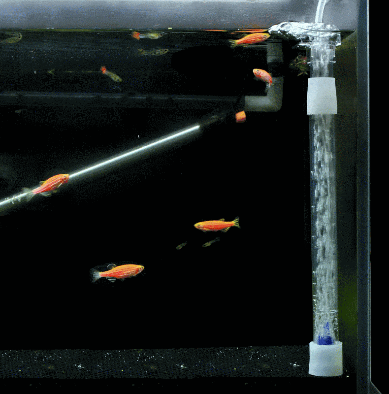

I have a fish tank into which is flowing a steady stream of water at around 2L/H. I set up a submerged pump controlled by a float switch to remove water at the same rate as it was coming in and so maintain a constant water level. The pumped water is discarded to a drain via a 6mm flexible tube. Problem I ran into was that when the pump turned off the water continued to drain from the tank by means of the siphon effect. I had the idea that making a small hole in the tube just above the water line would allow air to be sucked in and break the siphon. Providing the hole was small enough any water escaping through it when the pump was running should be small potatoes and so could be ignored.
Sure enough when the pump turned off air was sucked in but I was surprised to see the siphon continue to run even with a stream of bubbles mixed in. But then came the big surprise, while the siphon was running the water level remained constant to within a millimetre..! Since the water level wasn't rising the float switch and pump were never activated.
See the siphon in operation
HOW DOES IT WORK?
My experiments indicate the distance between the hole and the waterline is critical. A very small change in water level causes the flow to increase or decrease to compensate. Moving the hole up or down (simulating a change in water level) by only a millimetre or two results in a significant increased or decreased flow. I guess it's the venturi effect that causes the air to be sucked in but how is it controlling the water level? My theory is that the length of pipe between the water level and the apex of the siphon is made longer or shorter as the water level rises or falls causing the pressure differential to vary. Be interested to here what others think...
IN SUMMARY
There is no new science here, of that I'm sure. In all my years of fishkeeping I thought I had seen every type of siphon under the sun but I've never seen anything like this before. I'm sure it's practical as it's been running on one of my tanks with no issues for nearly two months. Is anyone out there already familiar with this application of a siphon?

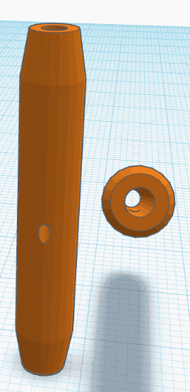

Hopefully the following will make things clearer...
The version in the video includes a small 3D printed part containing the hole.
Dimensions are OD 5mm ID 2mm small hole in side approximately 0.5mm.
You can see this printed part in the video. It is blue and connects the black tube below to the clear tube above. You can also see where the black tube enters the water. The clear tube goes over the side of the tank down to the floor and makes it's way to a drain. Assuming I start from a state of equilibrium I find moving the hole up or down some arbitrary distance will after a short time cause the water level to go up or down by a similar amount.

I just checked it out and it is exactly as you say... Air is sucked in the instant the hole rises above the water line. At equilibrium the hole is approximately 2.5cm above the waterline using the present setup.
The hole may well be smaller in practice as my 3D printer doesn't necessarily make a nice clean hole at this scale. Also the hole is slanted down so as to direct any squirting (when the pump is running) down towards the water.

Appears to me to be broken off as bubbles at the hole. If you freeze frame the video you can see the exact makeup and the individual bubbles.
There also appears to be a minimum flow required before air is sucked in. If I run the siphon near the bottom of it's range just before the siphon might break, it goes into a sort of fast slow cycle... As more bubbles enter the tube the flow quickly slows to almost stationary at which point air ceases to be sucked in and only water is entering the tube. As more water enters the tube and bubbles are exiting at the other end the flow begins to accelerate slowly at first but (I suspect) exponentially until air is again sucked in and the cycle repeats. Fascinating to watch for a nerd like me lol.
