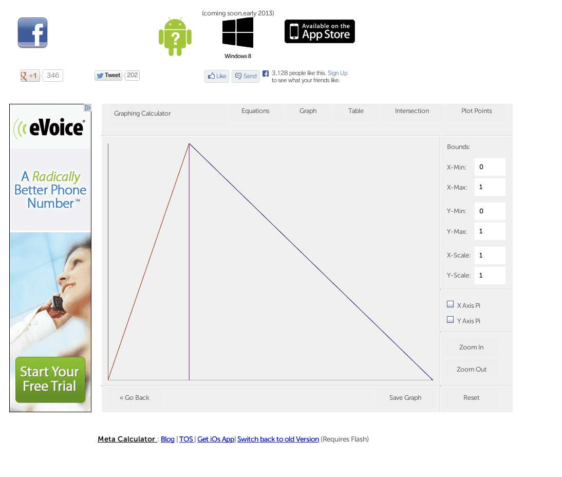

Here is my visual aid to MarkFL's idea. The line from the top vertex is perpendicular to the base making 2 right triangles. Denote the hypotenuse on the left as m^2 + n^2 as Euclid recommends, the bottom left leg as m^2 - n^2, the common leg as 2mn. Denote the hypotenuse on the right as k^2 + l^2, the bottom right leg as k^2 - l^2, the common leg as 2kl
2mn = 2kl
mn = kl
Now you're ready to plug in sme numbers and play. Use MarkFL's example (5, 12, 13). Put those numbers in the right triangle on the left with 12 as the common leg
2mn = 12 = 2kl
mn = 6 = kl
3*2 = 6 = 6*1
BEHOLD! There is your kl to give the other 2 sides.
k^2 - l^2 = 6^2 - 1^2 = 35
k^2 + l^2 = 6^2 + 1^2 = 37
So we generate MarkFL's example (5, 12, 13 ) , (12, 35, 37)
Notice corresponding side symmetry of 13^2 + 35^2 = 5^2 + 37^2.
For my example (20, 21, 29) we have to make a slight modification of this scheme, in particular, the common leg will be denoted as m^2 - n^2
Well, i hope you play around with this and see what you can come up with. Too bad i have limited graphing capability so i can't put the proper denotations on the sides myself. :)
