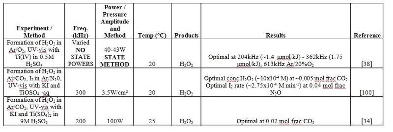

I'm having a real problem with Microsoft Word getting all the information I need onto the graph, it takes up too much room, example:
My attempt a TABLE in Word:

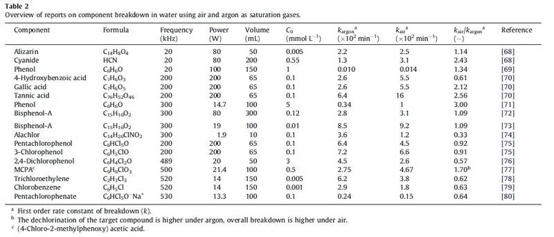

How I want it to look:
So just wondering what you guys use, or how you would go about creating the latter TABLE?

I did the above TABLE in Excel and copied and pasted it into Word, but find it looks nothing like the TABLES in scientific papers, they are usually without borders around the cells (like the above). I was wondering if there is some software that scientists generally use for making these tyoes of TABLES?Thanks for the advice though!

Table 1 is rather wordy in its content, while Table 2 pretty much contains only simple facts. Of the 2 tables, the latter would be the easier to format, using Word, Excel, or some other means. Table 1 can be cleaned up a bit, perhaps by changing fonts and working with inter-cell formatting options, but it probably would not look like Table 2 even with this extra work.

The table from the paper is very very likely created in LaTeX. It's much easier to make professional looking tables etc with LaTeX.

I am a big fan of LaTeX, too, but creating and formatting tables is certainly not one of its strengths. There are zillions of packages which promise to provide "professional" looking tables, but mostly, they cover only few of the aspects of the table you want or have to create. E.g. I had notoriously problems to get correct formatting when using footnotes inside the tables.

That's a good point (as the half hour I spent making a table that spans the width of a column of text the other day). I'd still say that I'm 99.9% sure the above table is LaTeX, and that the results look professional once you've got it right. Perhaps it's not easier than other options, but dang, they can look good.

The table above contains quite a lot of points which need quite advanced knowledge of latex: alignment on the decimal point, roman formatting of the chemical formulas, footnotes in the table. Nevertheless, the table is probably to broad for one page. The latex code for creating this table will be almost ininintelligible in a text editor and therefore difficult to manage.

I don't disagree. Latex formatting of tables can be pain (I think less of a pain than you're making it out to be, but each to their own). And yet, there don't seem to be better options around.
