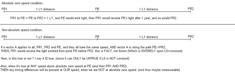

  • #43
I'd say the sun goes in an outward spiral away from the center of the galaxy, much like a very very very very high orbit..and the Earth circles the sun..
But that's not all, because each galaxy is also spiraling outward from the center of the universe..
Now for what speed we have, here's a practical experiment..
Since we assume the speed of light to be an absolute, traveling from a point to another,
it will mean that every bit of speed we already have is deducted from the light speed..
So, when we have a vector A, and we are traveling along that vector,
any emission of light along that vector will be LS - speed along that vector..
While that is true the opposite will also be true, namely the relative speed from anything
along vector -A will be LS+ speed along vector A..
So, when we measure the time it takes for a beam of light along any 3 vectors being at
exactly 90 degrees from each other,we can calculate our actual speed and vector..
But do take into account that we also have computers that work along that same principle..
The best way to equalize their internal cronometers is equal distant to all three points of measurement, and as far away as possible.
(to minimize the differences in each vector towards the points of measurement..)
Since I do not have a lab, someone else will have to do this..
I'm certain that an alpha-like processing unit can measure time at 10Ghz, if not 100Ghz,
when specially designed for it..
At 10 Ghz the distance light travels will be 0.03 meters per Hertz,
but I'd say 3 mm per hertz is better to use..
Then when the light is registered, don't go for exact timings by a central processing unit,
but the number of ticks from each measurement processing unit..
I'd love to see the results..
note:Also, this experiment would also tell us if the LS is actually as constant as we assume it to be..
Since there would be an actual difference in ticks, if the test is one exact enough..
However, if there's no difference, than LS only is LS when measured from the point of emission..
(and that would mean that LS isn't exactly the barrier we think it is till now..)
I meant vector EB, EC and ED roughly equal to each other..not AB, AC and AD..sorry..
Note that If AB= (1,0,0) and AC=(0,1,0) and AE=(0,0,1), then AE would be x(1,1,1)..
(with x being as large as humanly possible..)
  • #44
I doubt that the path of a star in a system like the galaxy is anywhere near that simple. Do you have a reference for this claim?
There is no such place.
ZMacZ said:
when we have a vector A, and we are traveling along that vector, any emission of light along that vector will be LS - speed along that vector..
The speed of light is independent of its source. So all that follows from this is wrong.
There are tests of the isotropy of the one way speed of light. See the experimental basis of SR FAQ at the top of this forum.
We have actually tested this, you know. You might want to look up Bertozzi's video of accelerating electrons. It's on YouTube. He demonstrates that the electron speed gets closer and closer to c as he pumps nore energy in - but never reaches it.
  • #45
I'm not 100% sure what you're saying here, but it sounds like you're saying that velocities add linearly: If I am traveling at speed v relative to the center of the galaxy (say) and I send out a signal traveling a speed w relative to me, then it will be traveling at speed v+w relative to the center of the galaxy. Relativity specifically says that velocities don't work that way. Instead, the velocity relative to the center of the galaxy will be ##\frac{v+w}{1+\frac{vw}{c^2}}## (where ##c## is the speed of light and ##c^2## means ##c \times c##). Note that if ##v=c## or ##w=c## then the result is ##c##:
##\frac{v+c}{1+\frac{vc}{c^2}} = c##
  • #46
@Ibix, no matter what the test will stand..whether the LS is a true absolute or not..
@Ibix, you may deny the Big Bang, I however do not..
@Ibix, the speed of light may very well be an absolute, I'm not so sure about this, in any case the test will prove it's merit either way..
(this does not mean I say that it is not..only after a thorough test of this by me myself would I know, all other things are hearsay to me..)
(and yes, if LS is a true absolute it would mean that any speed we initially have would be added upon the time traveled to any measured point,
if and when vectors align, and be deducted when they are opposite..)
@stevendaryl, If the LS is a true absolute the test will confirm our current speed and direction..
@Ibix, If traveling at 0.5 LS we emit some light beam ahead of us, it would only travel forward along the vector we travel with
a relative speed of 0.5 LS, right ? So from a receiver's perspective along taht same heading would the LS not only be 0.5 LS ?
In other words, if the receiver would be 1 LY ahead from the emitter , but also traveling at 0.5 LS, would
the perceiver only see it after 2 years ? (1 LY/0.5 LS) I think so..you may differ if you want..
(but also, if it would NOT be 2 years, it would change the whole way light actually works, wouldn't it ?)
I mean not that the speed of light actually changes, but the perceived speed..
  • #47
Where do you think I did that?
Check out the experimental basis of SR FAQ for extensive evidence.
No it doesn't. See the velocity addition formula in Steven's reply.
This is horribly confusing because it's not at all clear who is moving with respect to what, but I think you need to read the velocity addition formula again.
  • #48
Okay. What you're saying is contrary to relativity. Physics Forums is for discussions of boring established theories, such as relativity, rather than being a place for you to post your own theory. Submit to a journal, if you want to publish your own theory.
  • #49
You guys really don't get it right ?
If each point of measuement from our lightpulse would be exactly one LY away in each axis, then they would be
receiving the lightpulse at exactly 1 year after emission right ?
But, if we're not, and the points of measurement are a relative distance constant to ours,
the time measured for each reception of the lightpulse would tell us about our own speed..
Since they would differ..
The experiment is BASED on the assumed fact that LS is constant, not to go AGAINST it..
In fact, it would confirm it's constant-ness..as well as tell us something about our velocity and vector..
(and also it would allow us to find out our near exact speed in the universe..)
  • #50

Ok then..here we go..
Now in one simple question, is this true, according to you...
(it'll help me with your responses as well..)
As noted, Michelson and Morley did this more thoroughly over a century ago, and avoided all the clock synchronisation problems you haven't noticed with your design.
The two setups will give identical results assuming the distances are measured using rulers at rest with respect to the source and receivers and the same clock synchronisation procedure is used. There is no universal rest frame, so the experiments are identical.

  • #55
I think that you really don't understand what relativity says about this thought experiment. I'm not exactly sure what your PE, PR1 and PR2 are supposed to be, but let's suppose that we have two planets that are at a constant distance of 2 light-years apart, according to their own reference frame. Call them A and B. Call their rest frame the AB frame. You have a rocket ship C that is traveling at 90% of the speed of light in the direction from A to B. Let's call its rest frame the C frame. When C gets half-way between A and B, it sends out two light signals: one to A and one to B. Then:
According to the AB frame:
  1. The distance between A and B is 2 light years.
  2. A is traveling at speed 0.
  3. B is traveling at speed 0.
  4. C is traveling at 90% of the speed of light.
  5. The light arrives at A one year later.
  6. It also arrives at B at the same time, one year later.
In this frame, the signals arrive simultaneously.
According to the C frame:
  1. The distance between A and B is only 0.87 light years.
  2. A is traveling at 90% the speed of light away from C.
  3. B is traveling at 90% the speed of light toward C.
  4. C is traveling at speed 0.
  5. The light arrives at A 4.36 years later.
  6. The light arrives at B 0.229 years later.
In this frame, the light arrives at B 4 years before it arrives at A.
  • #56
ZMacZ said:
does this means there will be no difference in ticks with my initial testing formation ?
Assuming that you have three receivers equal distances from one source, all mutually at rest, and you've synchronised all three clocks using the same procedure then you will get the same results from all three arms under all circumstances. Have you looked up the Michelson and Morley experiment yet?
  • #57
@stevendaryl..yes..you got it..
But did you know it will also work at our non-relativistic speed, the same way ?..and that's how measuring time by the LS
will tell us about our actual speed in the universe..
@Ibix, nope...all the clocks are synchronized beforehand, and nope, the number of tciks since start will differ, except when we're not moving in the universe at all..
And yes, I looked those up too..but the thing with reflecting is this, whatever speed 'advantage you have on the way there, you'll get against on the way back..
But..when it's only one way and then measured, it'll be different, UNLESS we are all standing still and Earth doesn't move in the universe..
To me it's a mixed blessing...one one hand it will be expecting that LS is true constant, and thus
travelling faster by any means bound by LS will always yields a speed lower than LS..
On the other hand it will enable us to know exactly which way we are going and at what speed..
(So..!YAY! for measuring our speed, or !YAY! for FTL..but they are almost mutually exclusive..)
  • #58
No, that's not correct. You can figure out your speed relative to some other slower-than-light object, but there is no such thing as "actual speed" in relativity.
Look, what you're saying is contrary to relativity. It's your own theory. We don't discuss people's private theories in Physics Forums.
  • #59
No it won't - Michelson and Morley demonstrated that. You are contradicting experiment, which means you're off in fantasy land.
True.
False. It's impossible to make a one-way measurement of the speed off light without assuming your answer. So the speed can be anything you like. It depends on how you synchronise your clocks - and if you use the same synchronisation procedure all three arms will give the same result.
