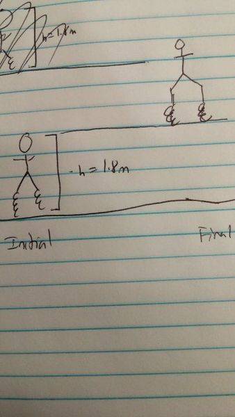

How i wanted it to be
A quick sketch

This is too unstable to bring you very high. You need something like this:
