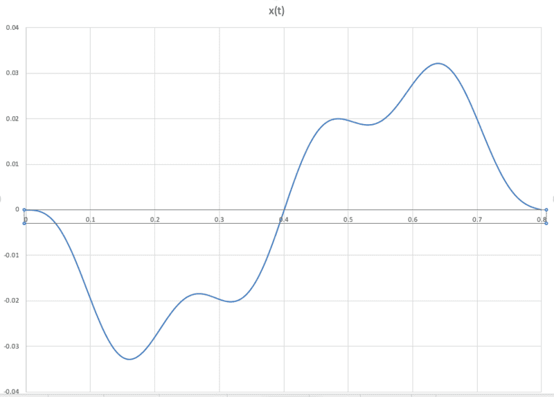

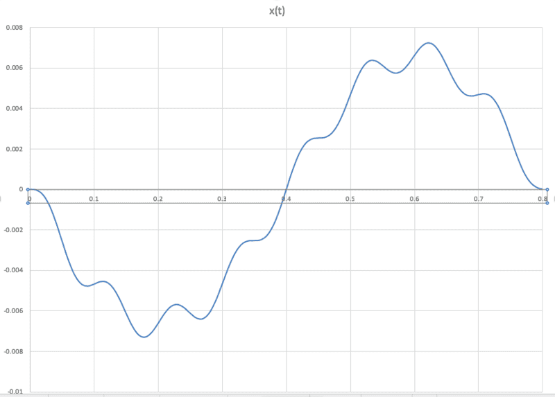

I approached this problem using the driven mass-spring equation:
$$m \frac {d^2 x} {d t^2} + c \frac {dx} {dt} + kx = F_0 \cos (\omega t + \phi)$$
The solution for x(t) is too long to write out here, but you can look it up, for example on hyperphysics. Using the general solution for x(t), I plugged in some values for the variables (##F_0 = 2000N, m = 65kg, \omega = 7.9rad/s, c = 0## and the appropriate phase) and analyzed the motion over the first half period (0 to ##\pi##) for different values of k. As suggested above, low values for k result in a longer period for the spring relative to the force period. When k is set to the resonant frequency, the spring returns to equilibrium as the force ends. And for high values of k, the spring exhibits complex harmonics. It would seem that the presence of a spring platform affects the jump height for values of k above and below resonance. Can this be correct? It would seem to violate conservation of energy. This function for x(t) assumes a point mass attached to the the spring, so the position x(t) is for the spring platform level. I realize it does not describe the position of the COM for the person jumping. Nevertheless, is it an appropriate function for the spring platform? Or is this the wrong diff. eqn due to the mass being the force actuator as opposed to the force being external?

Thanks for the clarifying questions. I want to model reality, where the board is not stuck to the feet. In Matlab, I attempted to model the limit to the leg extension (force never attractive) by using a window function to stop the force after once cycle. Then only gravity would be pushing on the mass after leg extension and with a high enough amplitude, you should be able to model lift-off. But the model shows the springboard oscillating at its natural frequency, which for high k, is higher than the force frequency. It seems that the platform height should move smoothly according to ##F(t)_{net} = kx##, essentially following the net force by a factor k over that first cycle. Do the high frequency oscillations point to a problem in the equation setup?

The standard solution for forced-damped assumes it to have settled down to oscillate at the driving frequency.
Since you are only modelling for one oscillation of the driver you will need to allow for the transient solutions:

Thank you. This all makes sense. It is interesting to look at the spring motion as ##\omega_{spring} / \omega_{legs}## gets larger than 1.0. These graphs of output show the harmonics I was referring to. ##\omega_{spring}/\omega_{legs} = 1, 4, 8.## Showing a half period. This solution includes the transient term. Would you only see this behavior with feet stuck to the spring board? If so, for feet not stuck, the mass-less spring board would simply follow the force impulse?

correction, full period (0.8).
