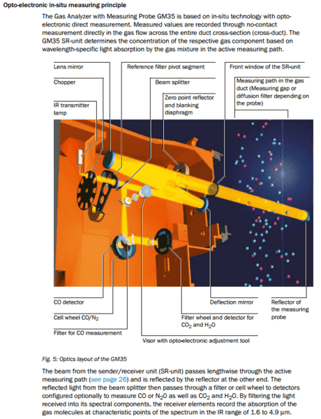

I'm trying to understand more about gas sensors. I know a lot about electrochemical and metaloxide sensors. I've faced all the limits that those sensors presents when you are using them outdoors.
Now I'm wondering how the gas sensors stations can measure different gases with such precission. I suppose that they use different gas sensors and I'd like to know more about them.
Does anyone knows about this professional gas sensors? Some web where I can start looking?

It's not about what sensor do I understand or not. What I'd like to know is which kind of sensors are inside this stations.
I've worked with metal-oxide and electrochemical. I know there are infrared, but what are the top ones? What kind of sensors are the ones that can certify that there is X concentration of the gas for sure?
Electrochemical sensors can not, cause they have the cross sensitivity issue which doesn't have a mathematical solution.
As Mr Baluncore has indicated, it's all lasers and mirrors.
https://www.sick.com/de/en/product-portfolio/gas-analyzers/in-situ-gas-analyzers/c/g284253
Cutaway diagram of the optics layout of the GM35 gas analyzer, showing the IR transmitter lamp, chopper, beam splitter, mirrors, CO detector, filter wheel and detector, and reflector of the measuring probe, with labels for the measuring path and front window.
