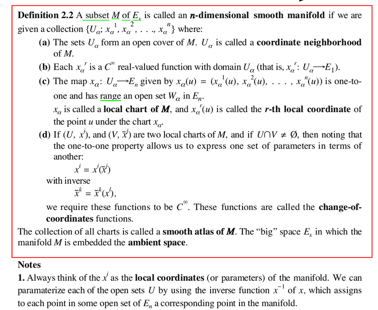

PeterDonis said:
The chart you are looking at is a global chart, not a local one.
I don't understand what you mean by "local" or "global" chart. To me a chart is a set of functions mapping the N+1 coordinates of the ambient (embedding) space to the N local coordinates of the N-dimensional manifold.
Here's another example of that type of charts: http://berkeleyscience.com/gr.htm
Why should you use curvilinear coordinates for T** and G** when you have the linear, local coordinates at your disposal?

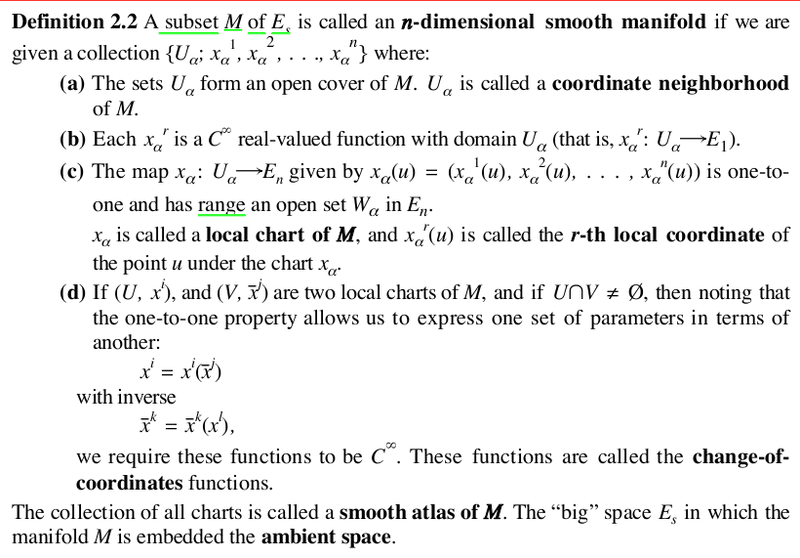

  • #62
That's not what a "chart" is in any GR textbook I've read, certainly not in any of the references you've been given, or in any of the Insights articles you've been referred to, or in the examples you yourself have been posting. In the example you've given, Schwarzschild coordinates in a spherically symmetric spacetime, the spacetime itself is a 4-dimensional manifold and you have 4 coordinates, ##t##, ##r##, ##\theta##, ##\phi##. Each point in the spacetime is labeled by a 4-tuple of coordinates, with appropriate properties of continuity. There is no "mapping" to any embedding space anywhere.
Since the chart covers the entire spacetime (at least in the example you're discussing--note that this would not be true in the case of a black hole, but you should not even try to understand that case until you understand the simpler case of a spherically symmetric massive body surrounded by vacuum, which is what the example you've been posting is describing), it is global. A "local" chart in GR is something like the Riemann normal coordinates I described earlier; the coordinates are "local" because the expression for the metric in these coordinates is exactly valid only at the single chosen point on which the coordinates are centered, and becomes more and more inaccurate as you get further away from that point. The expression for the metric in Schwarzschild coordinates, however, is valid everywhere.
You do not have "linear, local coordinates" at your disposal, not the way you are using that term. You do not have any embedding of spacetime in any higher dimensional Euclidean space. The examples you have given of embeddings are not of spacetime, they're of 2-surfaces in Euclidean 3-space. Those examples do not generalize to spacetime. They just don't. If you continue to insist on treating spacetime this way, this thread will be closed as that is not the way it is done in the GR literature and we cannot help you if you insist on continuing to try to understand it that way. It won't work.

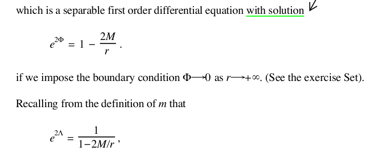

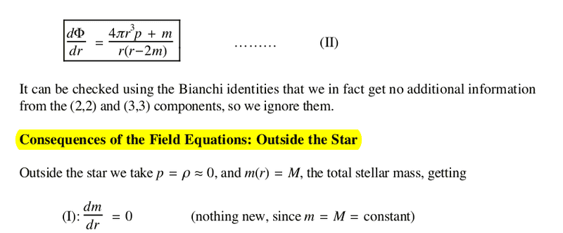

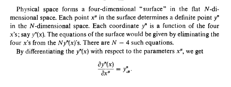

  • #75
PeterDonis said:
No, it isn't. It's a global coordinate on the spacetime. The chart you are looking at is a global chart, not a local one.
We're talking about the same thing. What I call "local coordinates" are what you call "global coordinates, labels attached to the spacetime events". I'm referring to the coordinates, each one ##\in E_1##, that a "local" chart covering all the manifold (thus actually a global chart) maps to, according to this definition:
To Waner's credit, he also notes that:
@PeterDonis I think I've got the solar system case. The link between the physical observation and the SET is very simple.
What about a more complex case, where you have multiple comparable masses in the same region? What kind of constraints should the physical observations put on the EFE?
Nugatory said:
That "rate of change of the normal vector" applies to extrinsic curvature and is completely irrelevant to general relativity
Somebody should tell it to this author:
The Rhijk are the components of the Riemann curvature tensor. Note that the Riemann curvature tensor is defined in terms of the Christoffel symbols, which are functions of the metric coefficients. The Lij and Lij are functions of how the normal vector U changes, i.e., the curvature of the surface. Gauss defined the curvature of a 2-d surface geometrically, and showed that it equals det([L])/det([g]). The Riemann curvature tensor allows the curvature to be computed from values that can be calculated in the surface, the gij. It provides the building blocks for the left side of Einstein's field equations.

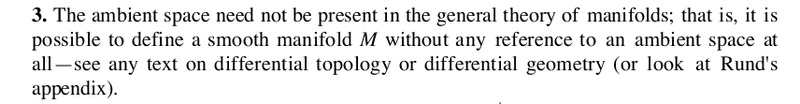

  • #76
Nugatory said:
The intrinsic curvature of a surface is defined by the Riemann tensor, and the Riemann tensor is defined by the behavior of infinitesimal vectors parallel transported within the manifold; no additional dimension is involved.
Just for the records, I've checked Dirac's General Theory Of Relativity and he also seems to adopt the approach of the immersion in the N+1 dimensional space when explaining the parallel transport:
  • Sad

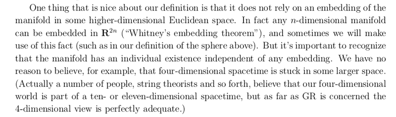

  • #77
Ok. That means the reference you give is using terrible terminology, different from the literature on GR written and used by physicsts.
No, somebody should, as I've already said, stop trying to learn physics from mathematicians. Physicists won't bother trying to tell the author this because none of them are going to read his book anyway. And mathematicians won't bother because they're not physicists and don't see the disconnect in the two bodies of literature.
That said, there is a key point that your reference fails to mention. It has chosen a particular embedding for the examples it gives of manifolds that makes the extrinsic curvature (the "rate of change of the normal vector") numerically equal to the intrinsic curvature (the Riemann tensor). But that does not make the two concepts identical, nor does it mean they will always be numerically equal for any embedding.
I strongly suggest that you take the time to read some references by physicists about GR, such as the ones we have already pointed out.

  • #78
Now check the references we gave you. What do they say?
Also note that Dirac does not say that ##N## dimensional curved spacetime is embedded in ##N + 1## dimensional flat space. He says that 4-dimensional spacetime can be treated as if it is embedded in ##N## dimensional flat space, without specifying what ##N## is. If you work it out, you will see that ##N## is not 4+1 in the case of 4-dimensional spacetime; it is greater (I think it works out to be 10 in the general case). Not all curved ##N## dimensional manifolds can be embedded in a flat ##N+1## dimensional space; that happens to be true for 2-dimensional manifolds but it does not generalize to higher dimensions.
