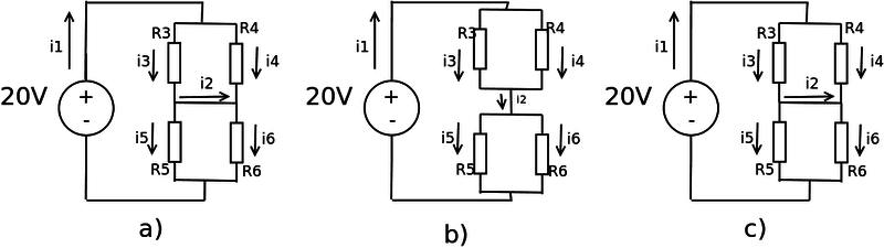

Compute i1 and i2 in Figure a). R3 = R4 = 6Ω, and R5 = R6 = 12Ω.
KVL and KCL
Since R3 / R5 = R4 / R6 , it's a Wheastone Bridge and i2 = 0, and i1 = [itex]\frac{20}{9}[/itex] A.
But my question is, why circuit in Figure b) is not equivalent to circuit in Figure a) when a) is a Wheastone Bridge?

The current through the vertical wire between the two pairs of parallel resistances is not equal to I2. Consider the Nodal Law. What is I2 in a) and what is it in b). Are they identical?
