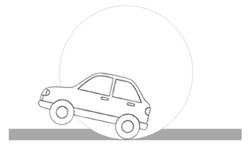

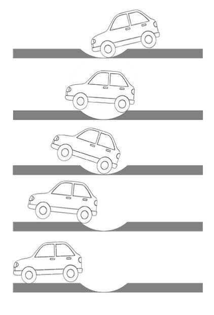

A 4x4 car is moving with constant speed V through a depression on the ground which can be approximate to an arc of a circumference, the length of which is equivalent to the wheelbase (inter axis) of the vehicle and the depth to half of the diameter of the wheels so that when the front wheels come out of the depression the rear ones are entering it. In that moment the vehicle rears up: the front wheels leave the ground, the rear ones continue their march inside the depression. After having drawn a short parabola in the air, the front wheels fall back to the ground, at the same time as the rear ones come out of the depression, detaching themselves from the ground only slightly. If possible, answer the following questions justifying the answer or why you cannot answers:
- Why do the front wheels leave the ground?
- Why are the rear wheels only slightly leave the ground?
- Is the weight of the vehicle equally distributed on the 4 wheels?
- Will the parabola drawn by the front wheels at the exit of the valley respond to the hourly law Z(x)=V0t+12Gt2 ? Are there other elements to take into account in the equation of motion? If possible, please write the correct equation.
Z(x)=V0t+1/2Gt^2
I ask for help in interpreting this question. Thank you !
I think the questions are very simple and direct, it's not an exercise where we have to do some calculations, perhaps this is a bit unusual, but here in Italy this is quite normal. Our math never adds up, but we're pretty deep in thought.:wink:
Why does the front of the machine lift off the ground? this is the first question. I would say there are more reasons. The first is that the velocity vector at the hole exit is inclined with respect to the ground due to the motion inside the crater itself. At the same time the rear of the car sinks into the hole.
Why do the rear wheels lift only slightly? The center of mass is probably shifted to the rear.
Can the trajectory be defined with an equation? For this I would need the help of some more competent and good-willed person. I think it is correct to apply the clockwise law of parabolic motion, but at the same time the center of mass is not on the front wheels, so something else must be written into the equation.

The text description of the geometry makes it clear that, for an instant, the car is level with each wheel right on the edge of the dip. In that case, it will not rear up. The rear wheels will lose contact with the ground briefly. The car will then start to rotate, but what is causing the rotation? The only force that can cause it is the normal force from the ground on the front wheels, so they do not leave the ground.
A bit later on, when the rear wheels hit the ground again, the front wheels might lose contact.

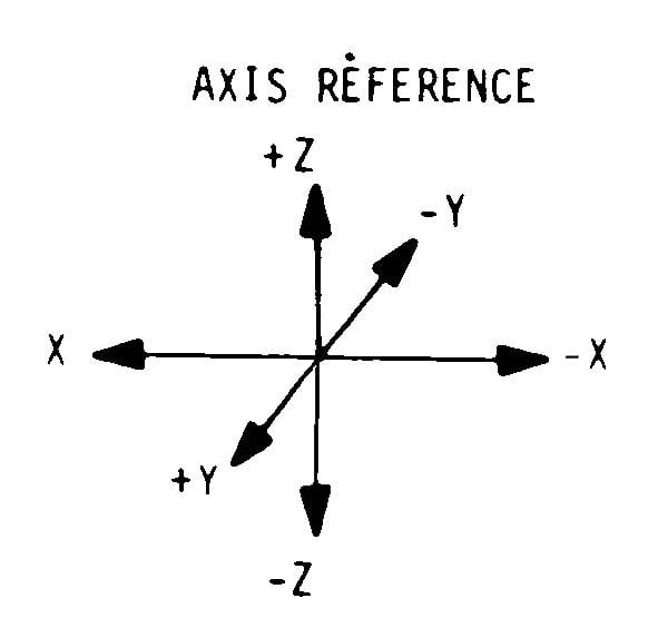

Obviously the equation of motion I was referring to is:
## Z(t) = V_0t + \frac {1}{2}gt^2 ##
Is it written g and not G even if it is not the terrestrial g?

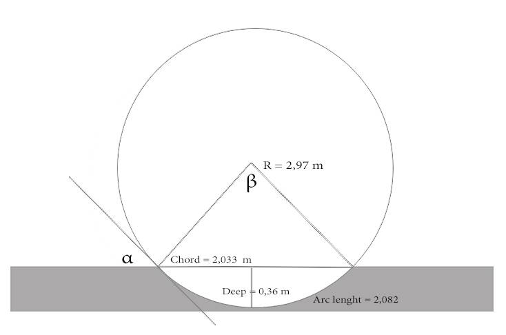

Let's say the wheelbase exactly matches the dip. Just before the front wheels escape the dip, the rear is still on level ground, so the whole is rotating (clockwise in the diagram).
That won't instantly cease to be the case when the front climbs out if the dip, so the whole will be airborne. That makes it easy to model subsequent motion since there is no angular acceleration.
If the dip arc has radius r, the normals at the ends make angle ##\theta## to the vertical, and the rear wheels have horizontal speed v at this point, write equations for the trajectories of front and rear wheels while airborne.

From the moment the rear wheels reach the dip and the front wheels exit it, the car is airborne. Its mass centre follows the usual parabola, but it is also rotating backwards at a constant rate. The wheels follow uniform circular motion relative to the mass centre, but it is not immediately clear whether the wheels are following parabolas relative to the ground.
To quantify that, we need to find expressions for velocity of the mass centre (horizontal and vertical components) and the rotation rate at the instant it becomes airborne.

Centre of the arc AB (the dip arc): (X=0; Z=0)
Length of the arc: AB = 2,82 m
Radius of the arc: r = 2,972 m
Angle subtended by the arc AB: β = 2α = 40°
Angle between ground and arc tangent at A and B: α = 20°
Initial speed of the car at the entrance to the dip: V0 = 2,6 m/s
g= 1,62 m/s2
X0 = r*SEN(α)
Z0 = r*COS(α)
Vx0 = V0*COS(α)
Vz0 = V0*SEN(α)
##Z(t)=Z_0 - Vz_0t+\frac {1}{2}gt^2##
##X(t)=X_0 - Vx_0t ##
##X(z)=\sqrt {r^2-Z(t)^2} ## (retrieval of the X coordinate on the circumference arc, given Z)
tZ(t)X(t)X(z)
0-2,791011,020061,02006
0,042-2,869720,853660,77134
0,083-2,965460,770450,19055
I hope I have clarified the fact that the car is not in free fall.

I have tried a scale drawing following your descriptions.
Wrong radius. We are talking about the convex lip of the dip, not the concave dip.
The axles would be traversing an arc with radius of 41 cm (0.41 meters) at a speed of 2.6 m/s as they come over the lip of the dip. The required acceleration is given by ##\frac{v^2}{r} = 16.48## m/s2. That is greater than the downward acceleration of gravity. Barring suspension travel, the rear wheels will come free of the ground.
In addition, the axles are accelerated upward by the centripetal acceleration from the rotation of the car. But that just makes them lift further still.
That doesn't seem to add up. If by length of arc you mean the chord then that should be ##2r\sin(\alpha)=2,02m##. If length along the arc, ##2r\alpha=2,075m##.
I'll take the radius and angle as correct for now.

If the distance between axles is 300 cm, as stated, all the numbers provided in this thread so far do not match.
Dear Lnewqban distance between axles is 2,286 m (90 inch).
The overall length of the car is 310cm (122 inch)
...this will be very usefull THANKS !!!

alex33 said:
the Arc of circumference is 2.082 cm long NOT 2.82 cm (I means length along the arc 2rα).
ok, but it made hardly any difference to the result I get.
(I assume you mean 2.082m, or as you would write it, 2,082m.)

That's a bit trickier. We have to make some assumption about how the rear wheels bounce and figure out the direction of bounce.
OK! I agree with this. If it's complicated then it has to be done.
After we've done that, I'll post the video of the real event that sparked the need for this study. Did I mention this is not an exercise? Reality may be different from a model, but it has the advantage that it can be observed. From the images I have available I can say that:
1) the car does not change its trajectory on the y axis once it comes out from the hole
2) there doesn't seem to be an impact from the rear wheels inside the hole, the ride proceeds gradually without bouncing or violent impacts.
But let's start from the formulas of motion at the time the front wheels leave the ground and the rear wheels enter the hole, since you haven't answered me on these.

The simplest way to look at it is that the centre of mass follows a parabola while the chassis rotates about it at a steady rate.
I have now added some spreadsheet lines for motion after the first touchdown. Again, please accept the rigid body view, i.e. it does bounce in effect.
I had to plug in a somewhat arbitrary value for the impulse from the ground. Just had to make it big enough that the rear does not continue down into the ground, but not so large that it increased the KE.
With a value at the low end of that range, I got that the rear touches down again just inside the dip, 0,3 seconds after the first touchdown. At this point, the front wheels were still 0,05 m off the ground.
With a value at the top end of that range, the front wheels hit the ground 0,3 seconds after the first touchdown, while the rear wheels were still 0,16m above ground.

I mean the car doesn't skid sideways (x-axis: horizontal, z-axis: vertical, y-axis: lateral)
