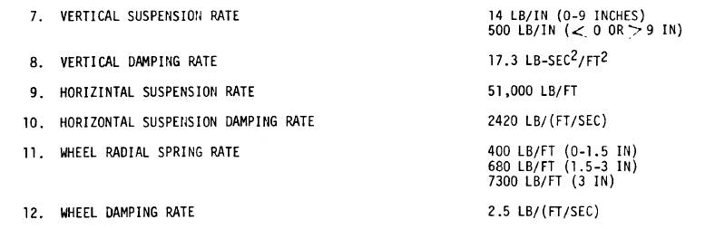

I'm a bit late to this discussion and I haven't read all the posts, but it looks like the main reason the front wheels leave the ground is suspension (including tyre) rebound. Look at the compression of particularly the RH front suspension in frames 0-16: that compression stores energy which is released in the following frames, accelerating the front of the vehicle upwards. This appears to be the dominant effect with torque and rotational momentum being negligable.
Or has this already been covered?
  • #74

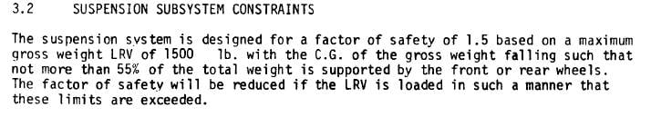

Dear pbuk thanks for joining this thread.
At the moment all those who have expressed an opinion agreed in considering the suspensions a marginal factor, certainly not the factor that triggers the jump. In fact I think the role of the suspension is to make the motion smoother without the vehicle constantly jumping.
I imagine this was the precise object of study for the Boeing Company that built the vehicle. I chose these frames in the famous sequence of the LRV Grand Prix, because it is one of the biggest jumps that the vehicle makes, even though the lunar ground is very bumpy.
As far as I can tell the comments about suspension were before (1) you revealed that you were talking about a vehicle in 1/6 of Earth gravity; (2) you revealed that you were talking about a Lunar Rover which has very different suspension design constraints to a normal car; (3) you revealed the video which clearly shows extensive compression and rebound.
What was your motivation for not revealing this vital information at the start of the thread? Did you not think it was important?
That is an interesting possibility, but I would think a lunar rover would have suspension that is particularly well damped.
I calculate that when the front wheels reach the top the mass centre is rising at 0.14m/s and the whole is pitching up at 0.27 rad/s. That would account for the front axle rising 10cm above its normal position shortly after, but whether that is enough to see daylight under the tyre I am unsure.
Doesn't look like it, particularly in the original video
The original video is somehow protected from my prying eyes. Don't forget this is lunar gravity, so it will look pretty bouncy even with well damped suspension.

Because the suspension (including the tyres) is compressed by the forward momentum of the vehicle as it decelerates due to hitting the front of the dip. The stored energy is then released, accelerating the front of the vehicle upwards.
alex33 said:
- Why are the rear wheels only slightly leave the ground?
Because the rear of the car is not subjected to as great vertical forces.
alex33 said:
- Is the weight of the vehicle equally distributed on the 4 wheels?
You can find online that the mass of the LRV is about 200kg. I estimate a suited astronaut weighs about 150kg. Look at where he is sitting on the vehicle: what do you think?

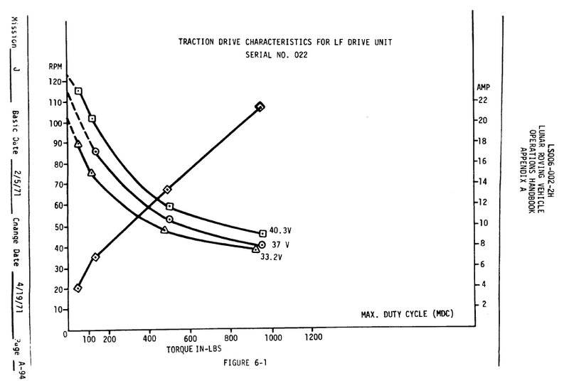

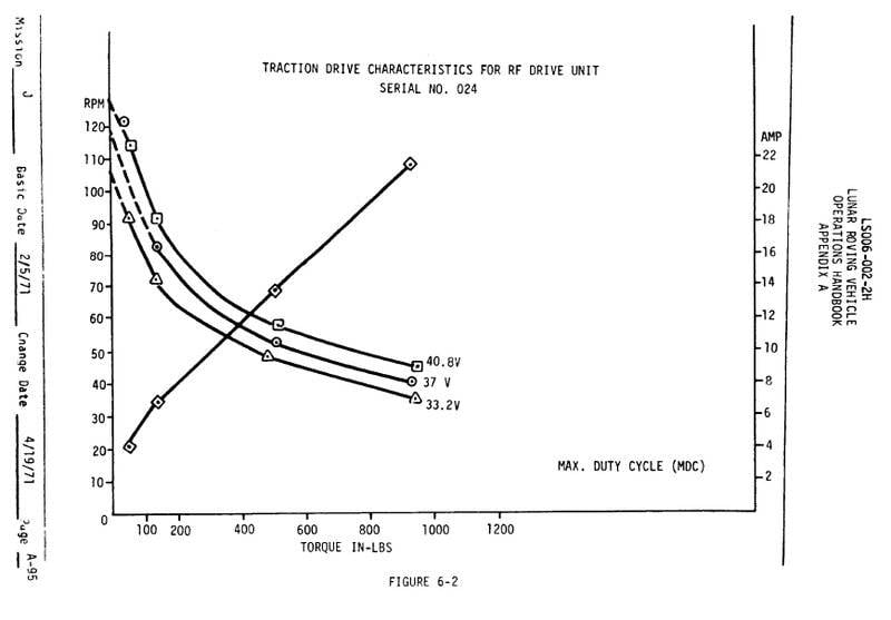

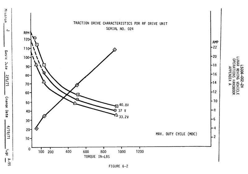

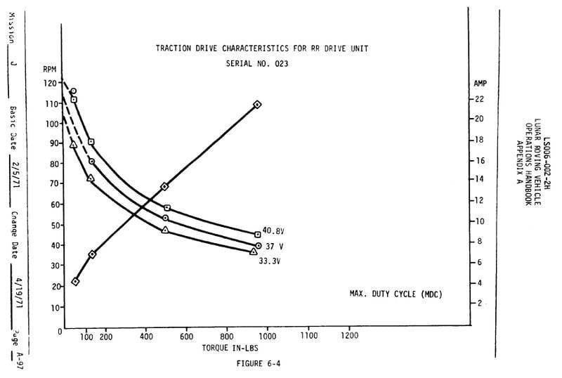

There is really a lot of data available in the NASA documents. We are already using some of them. My shortcoming is in physical modeling and for this I asked for help. Your proposal to study suspension has been met with interest. We have to work on it.
Yes,
I also think that since there is only one astronaut on board, the weight cannot be well distributed as official data say. It is rather a Y-axis problem, which we have never included in the discussion yet. But the mass of the astronaut was less than what you proposed.
The technical data tell us that this was the situation:
LRV MASS FULL LOADED = 1.520,40 LBs
Chassis = 462 LBs
Load vehicle with 620 pounds distributed as follows:
245 lb. driver seat
245 lb. passenger seat
130 lb. equally distributed over rear
That's just another way of looking at what we are already doing. Without suspension, the car will follow up the rising curve and leave the ground because of its linear and angular momenta. With suspension, that tracking of the ground curve is delayed.
The suspension cannot add any extra energy; indeed, it will absorb some. It will also make the effect less apparent because the wheels will drop back to the ground more rapidly than the chassis can follow.
