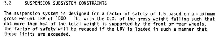

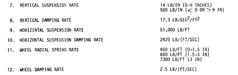

Furthermore I finded:
Vertical Damping rate 17.3 LB-Sec^2/FT^2
Horizontal Suspension Rate 51,000 LB/FT
Horizontal Suspension Damping rate 2420 LB/(FT/SEC)
Wheel Radial Spring Rate 400 LB/FT (0-1.5 IN)
680 LB/FT (1-5.3 IN)
7300 LB/FT (3IN)
Wheel Damping Rate 2,5 LB/(FT/SEC)

yes. I have a doubt (maybe stupid) ... to calculate the horizontal speed in the dip, should I take the measurement of the arc or the one of the chord? :rolleyes:

I'll see what I can deduce from the damping rate.
For horizontal speed, yes, use the chord.

SORRY... I had lost a data... there is one more...
VERTICAL SUSPENSION RATE 14 LB/IN (0-9 Inches)
500 LB/IN (< 0 or >9 IN)
SUSPENDED VEICLE MASS 1424 LBs

  • #109
7300 LB/FT (3IN)
I need the spring 'constant' for the suspension. The above look ok, but imply it is not constant over the range, which is a nuisance. And I do not understand how the last number fits in. How can it average 680 over 1 to 5.3 inches but be 7800 at 3 inches? Seems like a typo or two.
  • #110
I try to check if I find the constant .... but I'll check better tomorrow, now I'm about to fall off my chair because I'm sleepy
...nothing at the moment... sorry
  • #111
Yes, typo in post #106:
alex33 said:
1-5.3 IN
should read 1.5-3 IN.
Another puzzle is the vertical suspension rate. If it means what I think, I believe this should be more than the wheel spring rate, but it is only 170lb/ft. Anyway, it's the wheel spring rate that I need.
  • #112
So, It's my fault in the trascription of the spring rate, due to late night work... Solved!
For vertical suspension rate I read also 500 LB/IN out of the range 0-9 IN.
Please tell me if I have to find others informations...
  • #113
No, that'll do for now. I just have to figure out how to use it without painful algebra.
