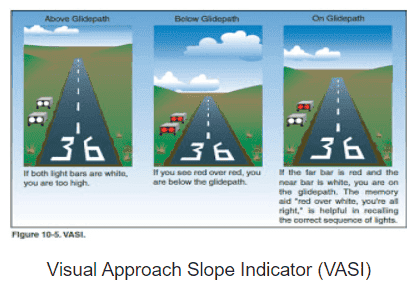

I have read several reports from WWII naval aviators using a system of lights and lenses to assist with night landing; on runways on land and at sea on a moving aircraft carrier. IMS one method employed Fresnel lenses and lights controlled by a landing officer (LO) stationed on a platform near the beginning of the landing zone. The aviator navigated to the airbase/carrier using printed maps and charts* following radio beacons then switched to voice comms before entering guide slope.
Given estimated aircraft weight and other characteristics and local weather data, the aviator was instructed to intersect the landing system lights at a certain altitude by the LO and 'follow the ball' of light down the guide slope to correctly intersect the mechanical arresting system on the flight deck/runway. The lenses were adjusted so that the light ("ball") indicated the optimum altitude to maintain proper guide slope.
That's called VASI, and it is used almost everywhere for a "visual" approach. ILS is used in bad weather or when the runway is still too far away to see.

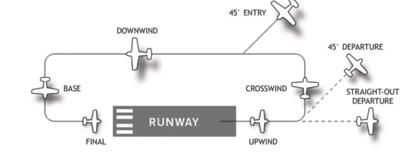

The idea of a pre-planned and practiced traffic pattern around an airport almost certainly originated from the Wright brothers, as then need and value becomes obvious the first time you decide to practice landings. You take off, make four left turns and then land again. Being able to fly that pattern exactly the same, repeatedly, is a basic/critical pilot skill. That includes following a prescribed glide path, whether it is marked for you or not.

For a descent to an airport you do indeed calculate where you should start your descent based on how much altitude you need to lose and your speed/rate of descent. For final approach and landing you do not.
It is true that the exactly duplicated traffic pattern has pre-calculated/planned distance and slope, but you're only eyeballing-it, and it can change with wind or traffic.
Say for example you're flying downwind, parallel to the airport and someone is in front of you. You wait for them to pass the other direction on their final approach before making your left turn onto base leg. Ordinarily you'd start descending to lose 200' before making that turn, but you figure you are too far and skip that. Somewhere on base you look out the window and see where the airport is vertically (the angle) and guess you're near the glideslope and start your descent (maybe you can't see the VASI/PAPI or it doesn't have one). When you turn final, you literally see where the airport is on the windshield and adjust your angle/rate of descent to compensate. Say you're below glideslope because you extended pretty far; you slow your rate of descent and watch as the runway moves down on your windscreen. That's how "seat of your pants" it is.

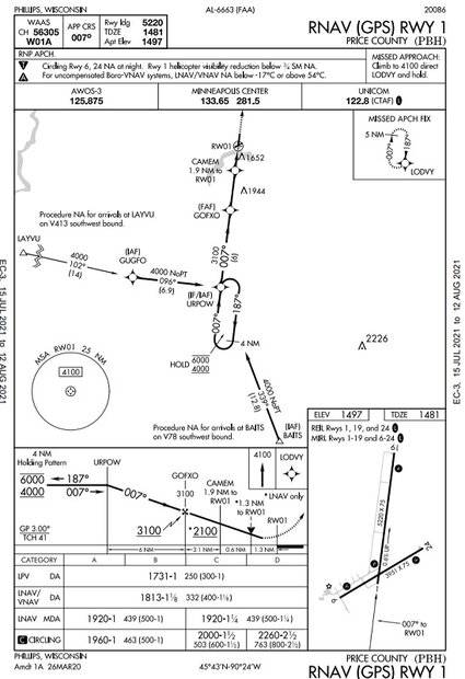

@russ_watters very nicely explains the techniques for flying Visual Flight Rules (VFR). Instrument Flight Rules (IFR) flying requires more instrumentation and more training. Modern IFR landing approaches are almost all based on GPS. The approach plate below shows a typical approach. It's for Runway 1 at my home airport.
The Cessna 172 I fly is category A in the table at the bottom left, while the local company jets flying in this afternoon are Category D. The C-172 has a GPS with LNAV capability, so the IFR approach procedure is as follows:
Fly to URPOW at an altitude above 4000 feet and below 6000 feet.
After passing URPOW, start descending so as to pass GOFXO at above 3100 feet.
After passing GOFXO, continue descending so as to pass CAMEM at above 2100 feet.
After passing CAMEM, descend to just above 1920 feet, and look for the runway. If you do not see the runway in time to make a safe landing, go around, and fly to a different airport.

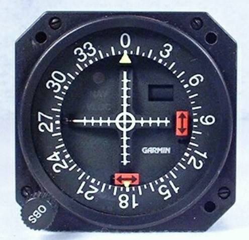

There is a needle for horizontal guidance. If the needle is to the left of center, turn left.

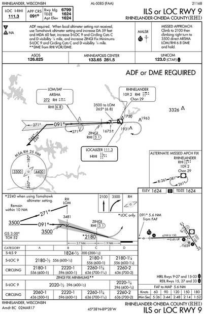

Other airplanes have GPS with vertical guidance capability. Those systems have an additional needle for vertical guidance. Those airplanes can fly to LPV minimums, which are 1730 feet at this runway. A typical panel indicator is shown:
When using vertical guidance, the airplane follows a straight path. When using only horizontal guidance, the airplane will either descend in a series of steps or in a straight path, depending on the skill of the pilot.
Later today I have to go to the airport and move the C-172 out of the hangar so they can park the two jets in there tonight.

There's no real disagreement here IMO. @jrmichler showed us an approach plate for instrument landings. @russ_watters I think was describing the "standard pattern" used for visual approaches, as shown in the picture below.
In the pattern, the final descent is started on the downwind leg. The pilot configures the plane for landing and establishes his standard rate of descent.
The issue of glideslopes, ILS radio aids, or VASI aids do not become relevant until the relatively short "final" leg of the pattern. But before reaching final, the aircraft should be stable on the standard angle of descent, and distance, and altitude.
Then on final, the VASI or ILS can be used to confirm that you are doing it right, not to establish the correct parameters.
Note that even commercial airliners regularly switch from instrument procedures to visual procedures when they have the runway in sight "Clear for the visual," is a frequently heard phrase from the air traffic controllers.

The approach plate in Post #10 is roughly 20 year old GPS technology. The technology before that used VOR and ILS. VHF Omnidirectional Range (VOR) is a transmitter. The pilot sets the frequency, turns the OBS knob (bottom photo in Post #10) until the needle centers, then keeps the needle on center until over the VOR transmitter. The compass ring gives the bearing from the transmitter.
The ILS consists of a localizer and glideslope. The localizer is a transmitter next to the runway that transmits a signal that gives left/right indication down the the runway. The glideslope is a transmitter that gives up/down information down to the runway. While the rules allow flying the ILS down to an altitude of (typically) 200 feet, the ILS works well enough to put the airplane onto the runway without seeing outside. I did this in training while under the hood. Once, with an instructor.
This technology was mature when I got my instrument rating in 1975.
Further research found this: https://en.wikipedia.org/wiki/Instrument_landing_system. The original ILS was first invented in 1929, and developed into its modern form about 1945. I don't know when approach charts developed into their modern form, but they look the same as those of 1975. Here's the ILS approach to a nearby airport:
A Cessna 172 can fly this approach down to 200 feet above ground in 1/2 mile visibility. At 200 feet and 1/2 mile, only the approach lights on the very end of the runway are visible when the pilot has to make the decision whether to land or to go around.

Stephen Tashi said:
This is the video motivated my question:
Am I missing something? 10500' is between 16 and 13 miles out, i.e. you can descend to that altitude in that distance range. No matter where your thumbs are: How can you possibly misread this chart, especially as a trained pilot who has certainly seen this type of chart many times before?
The video claims that was the theory advanced in the accident report. I too think that it sounds unlikely, but no other theories are available from the people who saw the evidence.
IMO, a more likely but less satisfying theory is that the pilot had "a senior moment."
