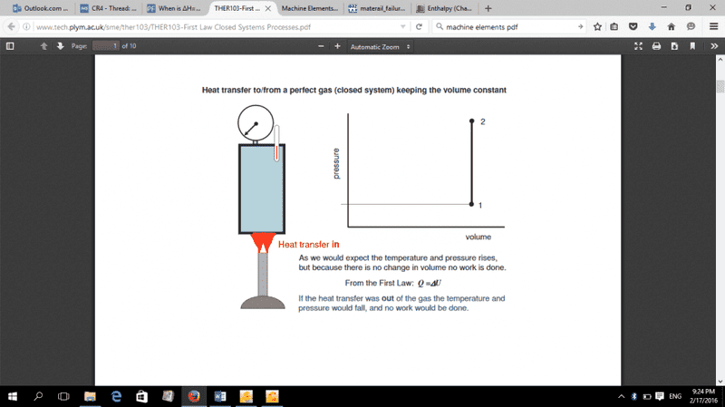

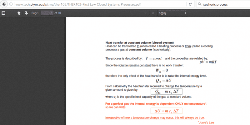

So, the analysis of below source is erroneous or probably lack some consideration of VdP? How would that differ with ΔH=ΔU?

Ronie Bayron said:
So, the analysis of below source is erroneous or probably lack some consideration of VdP? How would that differ with ΔH=ΔU? View attachment 95979
This derivation is correct. But I don't see any ΔH in there. So, what makes you think that this proved ΔH=ΔU? Here's what I get by continuing this analysis: $$ΔH=ΔU+Δ(PV)=nC_vΔT+nRΔT=n(C_v+R)ΔT=nC_pΔT$$
Do you have a problem with this.

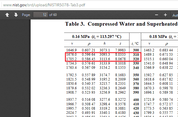

Oh yeah? What if I told you that, if you check your steam tables, you will find that the specific internal energy values u differ from the specific enthalpy values h by the product of the specific volume times the pressure vP? That is h = u + pV. What do you think about that? So even your own steam tables back up what I have been saying.

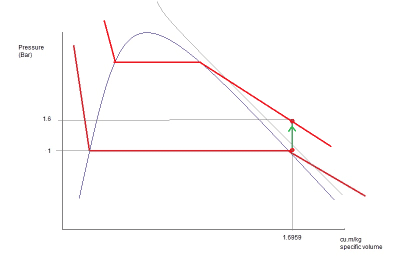

Oh yeah? What if I told you that, if you check your steam tables, you will find that the specific internal energy values u differ from the specific enthalpy values h by the product of the specific volume times the pressure vP? That is h = u + pV. What do you think about that? So even you own steam tables back up what I have been saying.
So, how do we connect ΔH=ΔU +VΔP in there for a constant volume analysis?

Chestermiller said:
Excellent! That summarizes the initial state of our system. Now, to get to our final state, we are going to gradually add heat to the 1 kg of vapor in our rigid container until its pressure is 1.5 bars. From your steam tables, what is the final temperature, volume, internal energy, and enthalpy of our vapor?
Chet
Let us just make it 1.6 bars to avoid numerous interpolation since its readily available on the table. Again, we recall initial state
@ initial state 1 bar, 1000C (we'll include entropy)
v = 1.6959 m3/kg
u = 2506.2 kJ/kg
h = 2675.8 kJ/kg
s = 7.3611 kJ/kg-K
@ Final State 1.6 bar, (s = 7.3611 kJ/kg-K) given process does not lost heat, ideally.
Values of T is in between 4000C and 5000C
