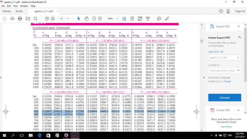

Do you have any to recommend? So what's the value of u and h @ 1.5 bars & v = 1.6959 m3/kg
I got one by googling "steam tables," but it was a PDF file, and I don't know how to get the actual URL. There are also steam tables in thermo books I have (that are consistent with the PDF table). In Moran et al, they give v = 1.695 m^3 at 280 C, with u = 2778.6 kJ/kg and h = 3032.8 kJ/kg. If you are comfortable using these values, we can continue.

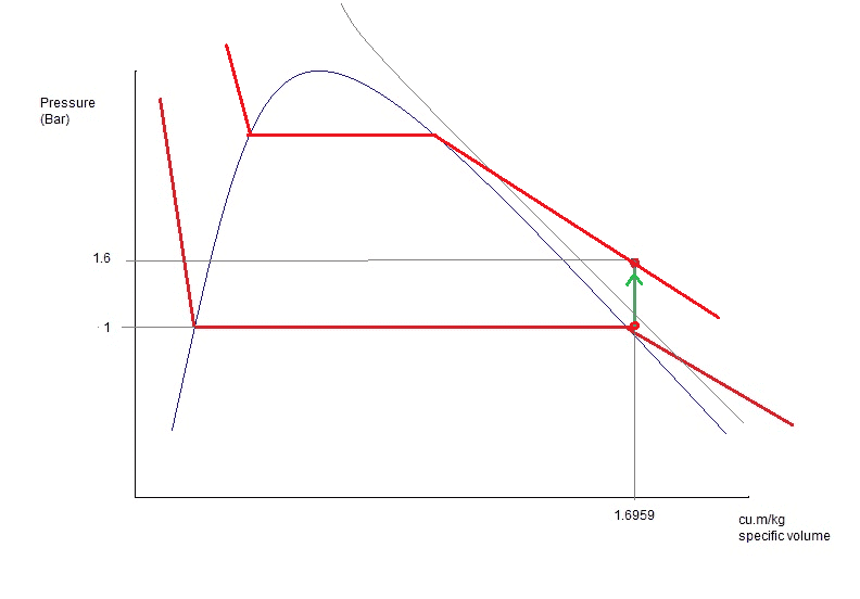

Pressure against specific volume diagram with a dark blue saturation dome and red isotherm lines; a green vertical arrow rises at constant specific volume 1.6959 cu.m/kg from pressure 1 bar to 1.6 bar.
This process of yours is better describe this way(p-v-t diagram). The two red lines are isotherms. Superheated steam @ 1 bar is raised to 1.6 bar at constant volume. This would mean one thing, you add up heat to the steam to raise its pressure at constant volume(obviously, since.transition is between 2 isotherms)
Applicable analysis would be ΔH = ΔU, since PΔV or flow work is zero.
The values @1.6 bar & 1.6959 m3/kg bar are in between highlighted values below
Excerpt of NIST table 3, Compressed Water and Superheated Steam at 0.16 MPa, showing specific volume v, density rho, enthalpy h, entropy s and temperature t in degrees C from 300 to 420; rows at 310 and 320 degrees C are boxed in red.

This is not correct. The definition of ΔH is ##\Delta H=\Delta U+\Delta (PV)##, not ##\Delta U+P\Delta V##. So, in this case of constant volume, ##\Delta H=\Delta U+V\Delta P##. The final internal energy and enthalpy are 2835.8 kJ/kg and 3107.1 kJ/kg, respectively, and the final temperature is 316.8 C. Even in the data you reported to me in your own post # 30, H and U differed from one another by ##PV## = 169.6 kJ/kg. Go back to whatever source you can find, and obtain the value of U at 1.6959 m^3/kg and 1.6 bars. You will find that the value is 2835.8 kJ/kg, as I indicated. So, for our constant volume change,
##\Delta H=3107.1-2675.8## = 431.3 kJ/kg
##\Delta U = 2835.8 - 2506.2## = 329.6 kJ/kg
So, ##\Delta H## and ##\Delta U## are not equal for our constant volume change (as also confirmed by my steam tables, which does give the U values).
The difference between these values of ##\Delta H## and ##\Delta U## is ##V\Delta P## = 1.6959 m^3/kg x 60 kPa = 101.7 kJ/kg
