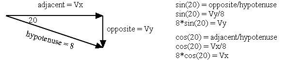

This is a more general question... but here is a specific example in which I don't know why sin is used where it is and why cos is used where it is. I don't need the problem worked out or anything (I have it worked out by my professor), I just need to understand why sin and cos are used when they are.
A ball is tossed from an upper story window of a building. The ball is given an initial velocity of 8 m/s at an angle of 20 degrees below the horizontal. It strike the ground 2 seconds later. How far horizontally from the base of the building does the ball strike the ground? Find the height from which the ball was thrown. How long does it take the ball to reach a point 10 m below the level of launching?

Pure geometry. Draw a triangle representing the initial velocity and you'll see why. The magnitude of the initial velocity is the hypotenuse of the triangle and the x and y components are the legs.
Initially, the velocity is at at angle of 20°.
So the initial vertical velocity is 8sin20 and the initial horizontal velocity is 8cos20.
It comes down to resolving vectors. Do you know how to do this?
initial velocity = 8 at 20 degrees below horizontal so
horizontal component Vx = 8*cos(20)
vertical component Vy = 8*sin(20) downward

No, I don't know how to resolve vectors.. I'm taking calc I and physics concurrently so I'm a little behind. I also am not sure how to draw a triangle representing the initial velocity (or anything for that matter).
Nice!
Okay, so I use cos in the x direction because the adjacent line to the angle known is in the x direction, and sin in the y direction because the opposite is in the y direction? This changes depending on the triangle and the angle known, yes?
Yes. At first you should use the definitions like cos A = adjacent/hypotenuse. After some practice you will be able to go straight to Vx = 8*cos(20).
